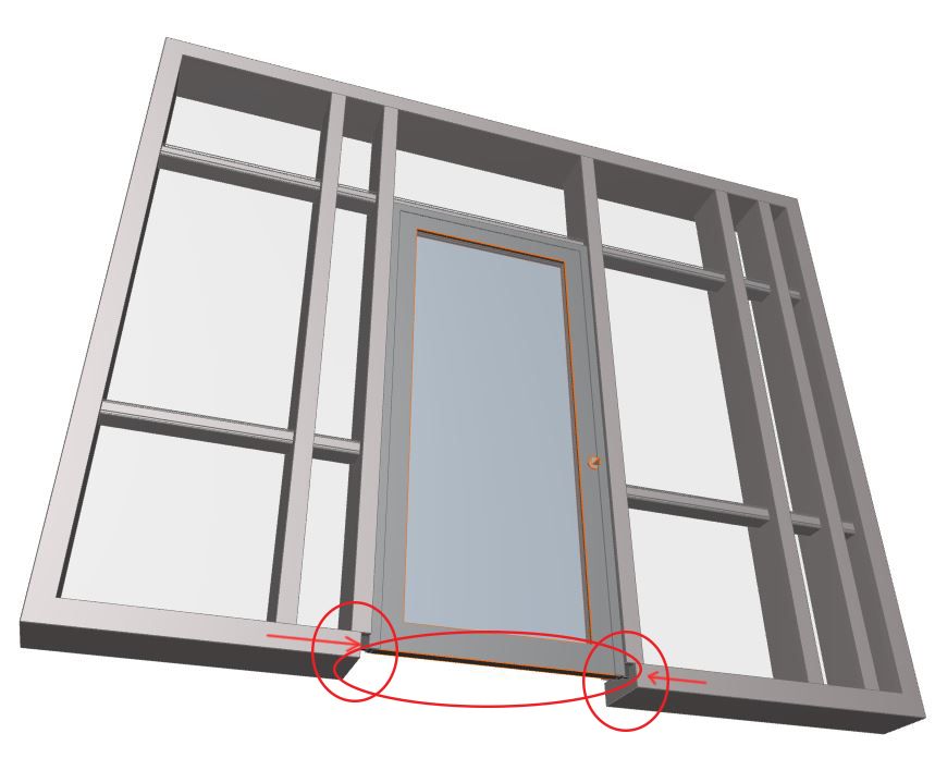

I've been exprerimenting with curtain walls and doors.
I try to create a door and I cannot figure out how to properly delete the bottom horizontal divider (?) and have the dividers next to it extend to the door.
The attachment will probably help you understand more than my description.
Cheers

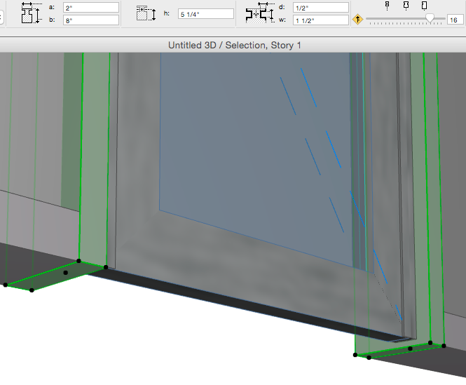

Eduardo Rolon
• Select the Invisible one and reduce its thickness
• Select the verticals (instead of the horizontals) and increase their priority

Eduardo Rolon
• select the invisible one and change thickness to "0"
• Its priority and the other boundary frames should be 15
• Set priority for the verticals to 17

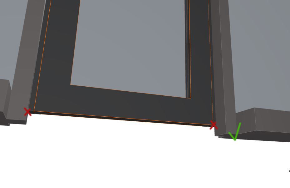

Hmmm....I notice that in your screenshot the line that represents the invisible is at the bottom edge and on mine its on the middle of the horrizontal element. Hence the 5cm.
Is there an option about the orientation of maybe a threshold?I tried your settings and the door is still elevated

With Eduardo's help,
I managed to get the dividers on the same lvl, I had to change the
"Boundary Frame position" from center to inside grid.Again,thnx alot Eduardo.
But now I am stuck with the door elevation....5cm!
