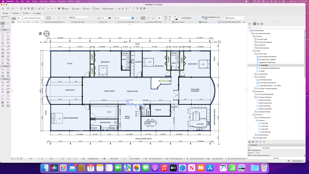

recently, the door openings on the drawing are not showing up. The doors do, but not the opening - the wall continues through the door. I'm sure it's a simple fix

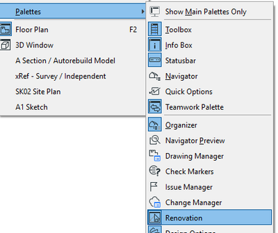

It turns out that the renovation status of the wall needs to be set to new, not existing. I need to set the default to new, and not existing. How do I do that? IS it something that is set on the template?
Lingwisyer
Guru
The doors and the wall just need to have the same status.

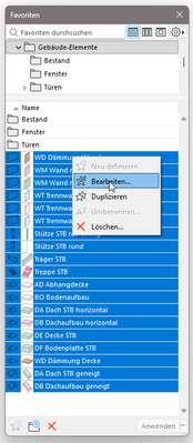

I think the setting is also saved to Favourites(?), in which case those would need to be updated.
Ling.
Stefan L_
Rockstar
No, it's not.
I just checked it 'cause I wanted to brag with my expertise: "You can edit multiple favorites at once!", but no need here.
