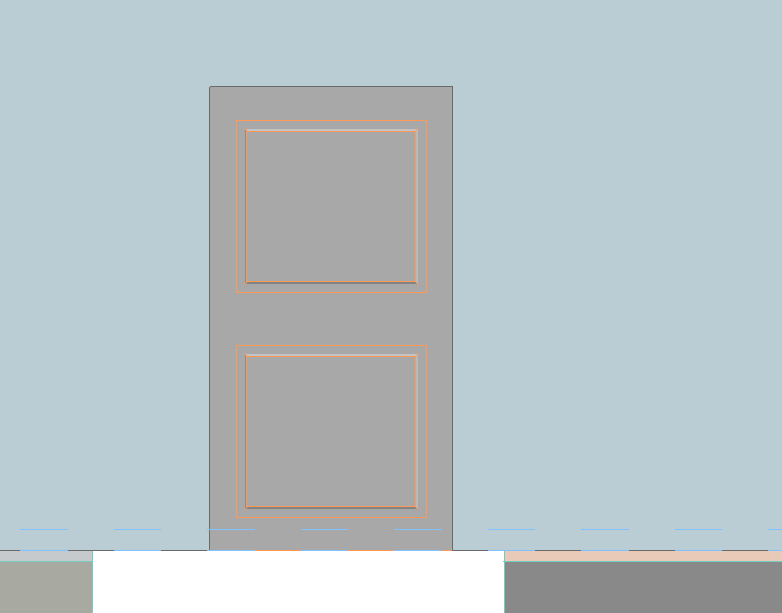

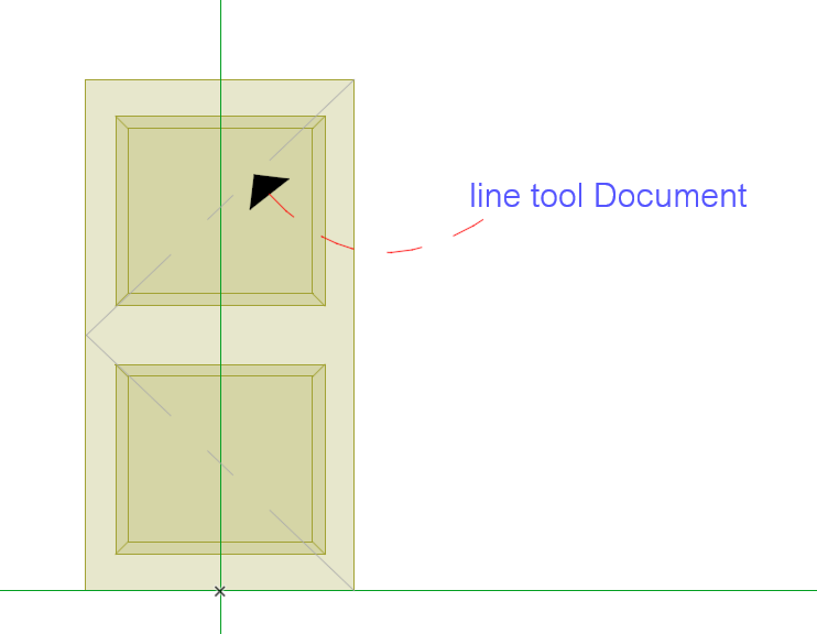

I create door panel and use line tool for door swing elevation.  (panel01)
But when i load to project the swing elevation is not show. (panel02)
Do i mistake something?
Thank you everyone for helping.
1 Solution
When you save 3D elements as an object, it will only use the 3D elements and not the 2D lines you may have placed in elevation.
If you really want to you could try using 3D morph lines.
However if you save this as a 'custom door leaf', then you can use that custom door leaf in any door object and it will automatically get the door swing from the door object itself.
