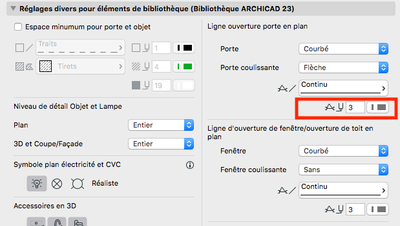

Hy,
The opening lines pen is set in MVO

Yves
Hy,

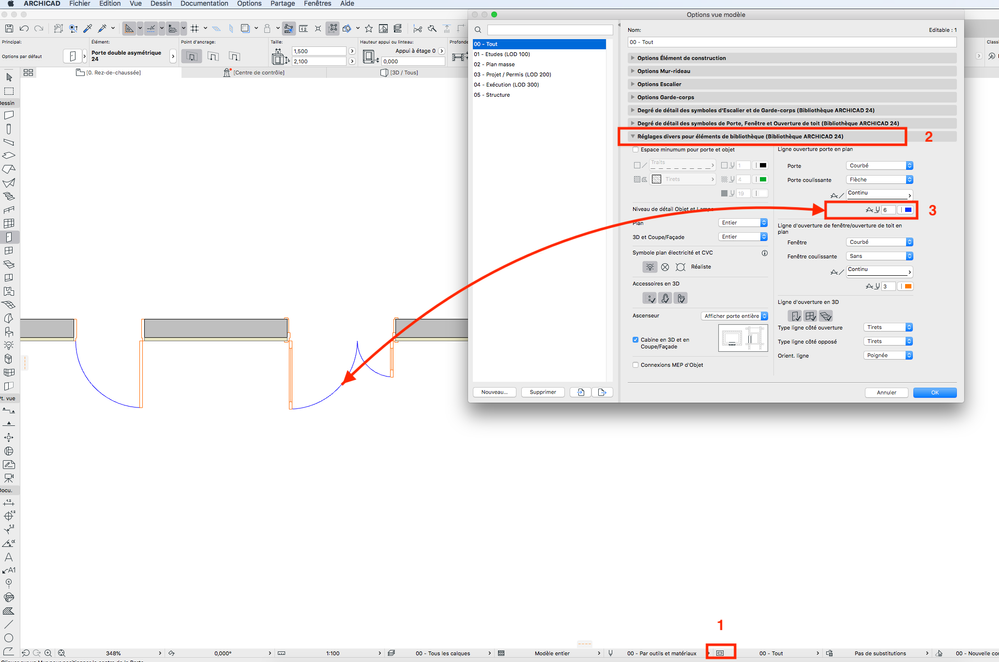

Hi Yves, thanks for the reply. Could you please show me where Ittings? It seems that your Archicad is in a different language, so it's hard to find exactly where the setting is. Thanks. can find the se
Yves

Sorry Im still confused☹️. could you explain more?
Yves
