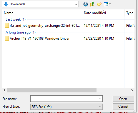

This is my first visit so be patient. I am attempting to download a revit family of chairs into Archicad 22 and save them as gdl objects. When I look in the folder RECENT FILES I can see the file I downloaded from the vendor's website "Chair-Hussey-Quattro-Revit_2020_1". But when I am in Archicad and go to Files, Libraries and objects, Import RFA as GDL Object, Downloads, the file is NOT in that Downloads folder. It will not allow me to go to RECENT FILES to find it. Is it because it is a Zip file or is there a step I skipped when I downloaded it from the vendor? Thank you in advance for any help you can provide!

unzip it and it should work.
