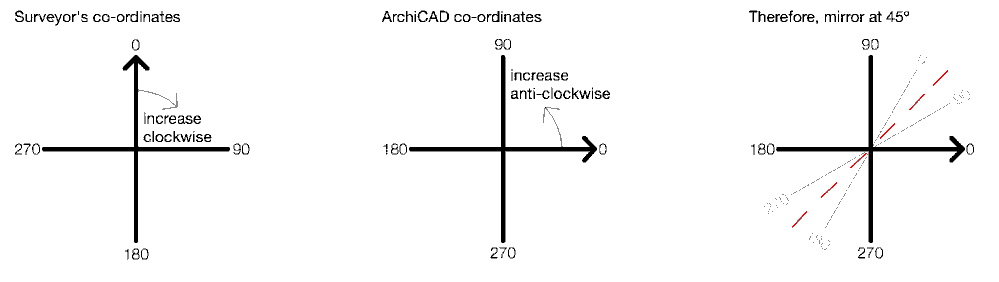

Hi Werner, It's funny that I was just explaining this to someone in my office less than a minute before reading your question. I assume that in South Africa the surveyors use a similar methodology to the ones in Australia. If not forgive me for using your thread as a mini tutorial for the Aussies having trouble.
This tutorial assumes that the survey's 0 degree point coincides with North and that the bearings increase clockwise.
If you haven't already, go to your Options/Project Preferences/Working Units menu an change your "angle unit:" to "degrees, minutes, seconds"
To enter the meets and bounds of a boundary with degrees, minutes and seconds start with the line tool, position it at the start and press enter or click to start your line drawing. Type "R" for the length value then "A" and enter the bearings by typing the angle, minutes and seconds separated by a space. (eg "132 25 15") then press enter to finish. You probably have a line that is not going in the same direction as the one on your survey. Mirror it at 45 degrees.
The reason is that ArchiCAD's co-ordinates go anti-clockwise from the right and the surveyor's go clockwise from the top. See attachment.
I suggest doing one line at the time because the surveyor's angle could be taken from either end of the line. You'll see in practice that mirroring at 45,135,225,315 still changes the angle of the line correctly so sometimes you may want to mirror at 135 degrees if the surveyor's andgle was taken from the opposite end point.
Another way, which is similar to Andrews, but does away with the mirror-ing at 45degrees step:
1. Click to start the line.
2. Drag your cursor in the direction of north (constrain with the Shift key).
3. Hit the R key, input the length.
4. Hit the A key, input the angle from survey (with spaces between degrees, minutes and seconds - if its 0 seconds you do not have to put in the 0)
5. Then hit the -(minus) key and hit ENTER.
This has the effect of adding your bearing to the north direction. You use the minus key as Archicad measures angles anti-clockwise, survey goes clockwise.
