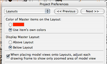

I'm a little confused about this. When I set up a view, I specify a certain zoom for that view. That zoom tells me what I can see in that view.
When I place that view in a layout, it places the entire drawing - not that view. Is there something I'm doing wrong?
In the image you can see how small the sheet is compared to the drawings being pulled in - I'm just trying to bring in a tiny portion of that drawing - which is what I see in the view.

It should come in cropped to the saved zoom extents by default. This is regardless of what the drawing defaults are.
So you tried changing it via the Drawing's Settings> set Frame to Manually resized frame. Is your drawing a long way from the project origin?
Do you have the latest version of AC11?

I wish it would come in that way.
Well, actually, what do you mean by saved zoom extents? Is that the zoom that I see when I open that particular view? If so, no, that's not coming in. The entire drawing is coming in.
After I manually resize the frame, then that box is checked by default.
In the original .dwg file that I brought in as a trace reference, the origin point was 900,000 feet away from the building. (No, I'm not kidding.) In order to correct that, I opened the original .dwg in ArchiCad and dragged the building back to the origin, then saved that drawing and merged the corrected drawing into this file.

in your Preferences>Layouts make sure that you have ticked the option to adjust each drawing frame to the zoomed area . . .
~/archiben
Wow.
Thank you. That works.
