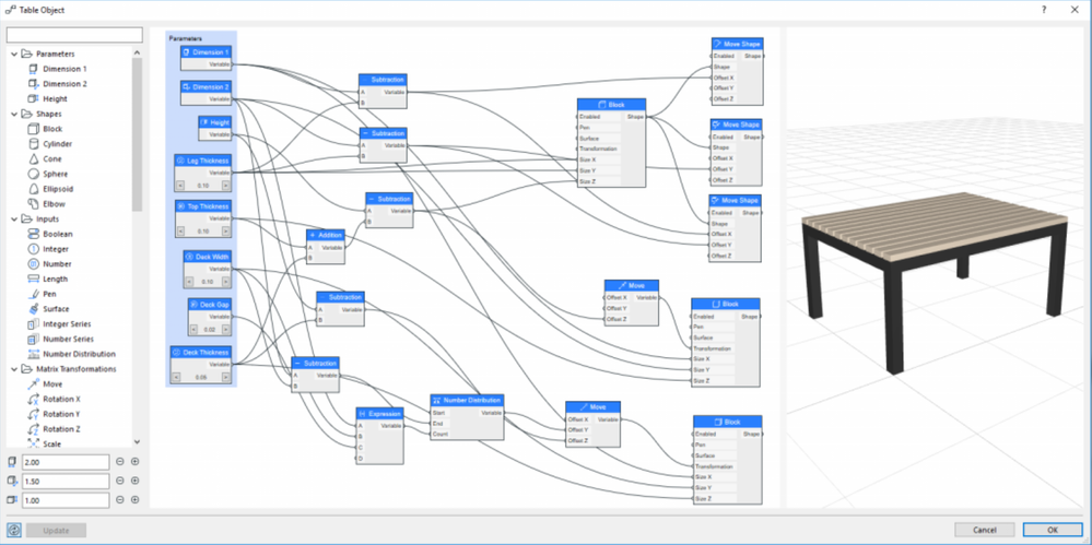

It depends some on what you mean by Dynamic Array.  Rhino comes to mind first.  You might want to checkout the Archicad PARAM-O tool which is being developed for something I think could be called a Dynamic Array.  PARAM-O – Graphisoft  2021-09-09_12-54-49.png
https://youtu.be/mgt_LDBvxC8

I used Param-O to build one and notionally it works okay:
However - the big problem is that you can't dynamically resize the array using editing nodes/handles. I think this is a complete showstopper actually. It does indeed work, and yes I can measure and adjust the numbers, but that's not a fluid and intuitive way of working, and in fact it's not good enough as a design tool for me. I had to build it though to find out that you can't stretch Param-O objects in all axes and have them parametrically adjust - bugger.
