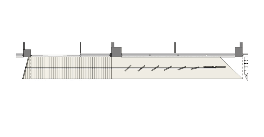

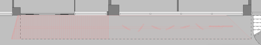

The design scenario involves creating the entrance canopy for a chocolate factory, providing an opportunity to use Archicad Design Options creatively. The concept combines a simple, clean canopy design with movable signage panels that convey messages related to marketing strategies and offer sun protection by adjusting their orientation on the south facade. The goal is to visualize changes to the building facade through the moving panels, showcasing various rotations, signage, and color combinations.
The canopy and the panels highlighted with redThe canopy and the panels highlighted with red
Modeling strategy
The project's main model is the existing building. Each variation's added elements have been designed in two Design Option Sets, corresponding to the main color combinations. Thus, I ended up with two Design Option Sets that hold the canopy's basic structure and multiple Design Options in other Sets to organize the panels' movement and signage.
The final Design Option Combinations integrate the basic structure with the instances of the moving panels.

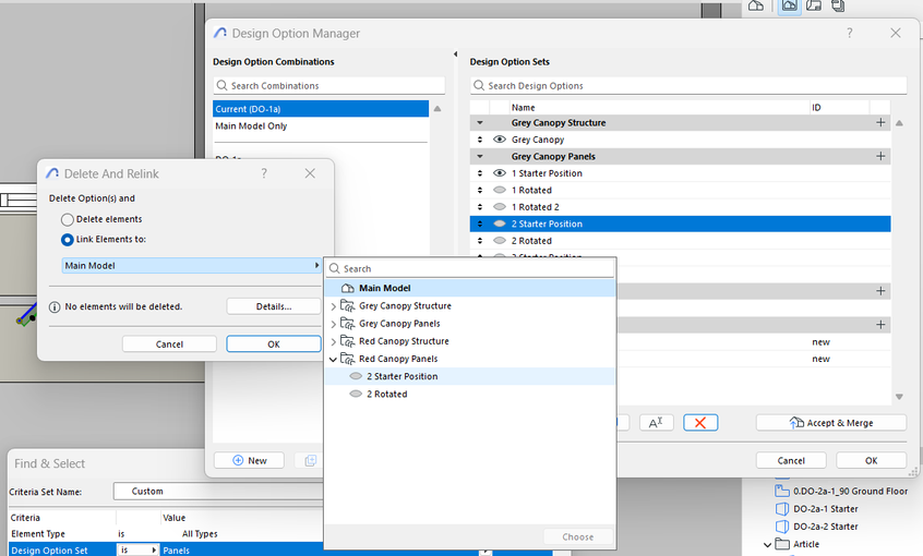

Useful tips: copying the elements from one Design Option to another
As this was my first trial using the new Archicad feature, I experimented with various methods to copy all or selected elements between Design Options within the same or different Sets.
  1. Duplicate the selected Design Option and modify the newly created elements within it:
    This method was handy for populating the panel rotations.
  2. Copying and pasting in place selected elements of a Design Option, then relinking them to a different one:
    This approach is ideal for quickly testing ideas based on existing designs. The Find & Select tool was helpful in this process.
  3. Using “Delete” after creating the new Design Options and Sets, then linking elements to them, as you cannot directly move a Design Option between Sets:
    This approach helps organize elements and achieve a clearer structure in the Design Option Manager, especially after initial brainstorming has caused file inconsistencies.

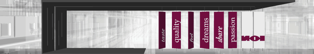

Final Outcome
Since loading each Design Option Combination can be time-consuming, creating animated GIFs is an effective way to present the concept:
Example 1
Example 2
