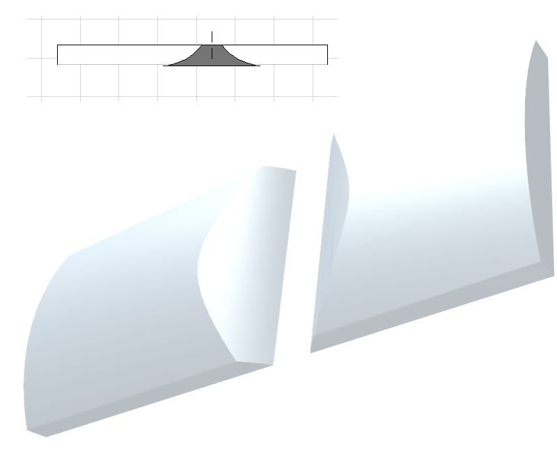

I'll respond with a cautious "yes", although it comes down to the specific detailing required. I've attached one example with a curved end. Is this what you had in mind?

1. Yes, all the objects were created with OBJECTiVE's toolset and required no additional GDL scripting. I don't believe GDL is a practical solution for the vast majority of ArchiCAD users.
2. I qualified my answer because I know what a deep subject architectural detailing can be. There are many possible answers to a given problem. I proposed one, but there are others that would be much harder to model.
3. You can save multiple objects into a single object, but then you lose all their intelligence and flexibility - you are left with (essentially) static geometry. If you keep the original parts, you can continue bending, twisting, or re-profiling etc as required. The assembly tools group a collection objects together (just like ArchiCAD's "Group") but add additional information for different working planes (so the entire assembly can be instantly translated into a different orientation).
