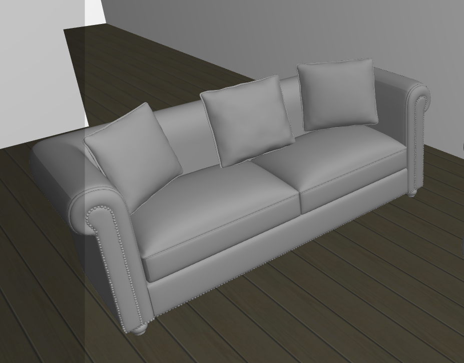

Sorry if this is a silly question, but I as a beginner am very confused about this. I have downloaded and placed a sofa in my interior, but when it is placed in the room, it appears plain grey. The image of it on the website was with colourful cushions and a light texture for the actual sofa, but I cannot find any way to make it appear the same in my model! The download folder has the texture images enclosed, so I wonder if there is any way to apply them on the objects?
Please help a fresh architecture student!

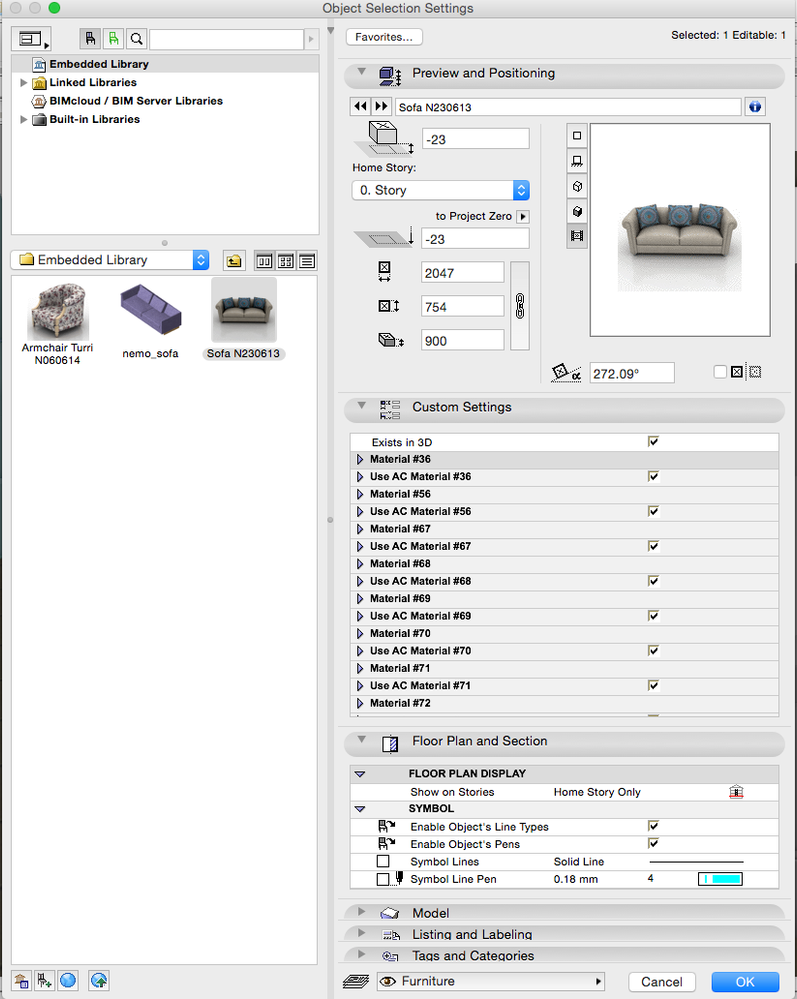

It's Archicad 18 for Mac.
Here is a screenshot of the properties.

Eaglette wrote:post the object and the folder and maybe i could look at it
Tried all sorts of combinations. If all boxes unticked, then it just turns black.

What do you see when you expand the blue triangle in the object settings.
There will be more options - maybe this will allow you to choose a material.

Barry wrote:Hi Barry, it seems to me that those are quite pointless.
Eaglette,
