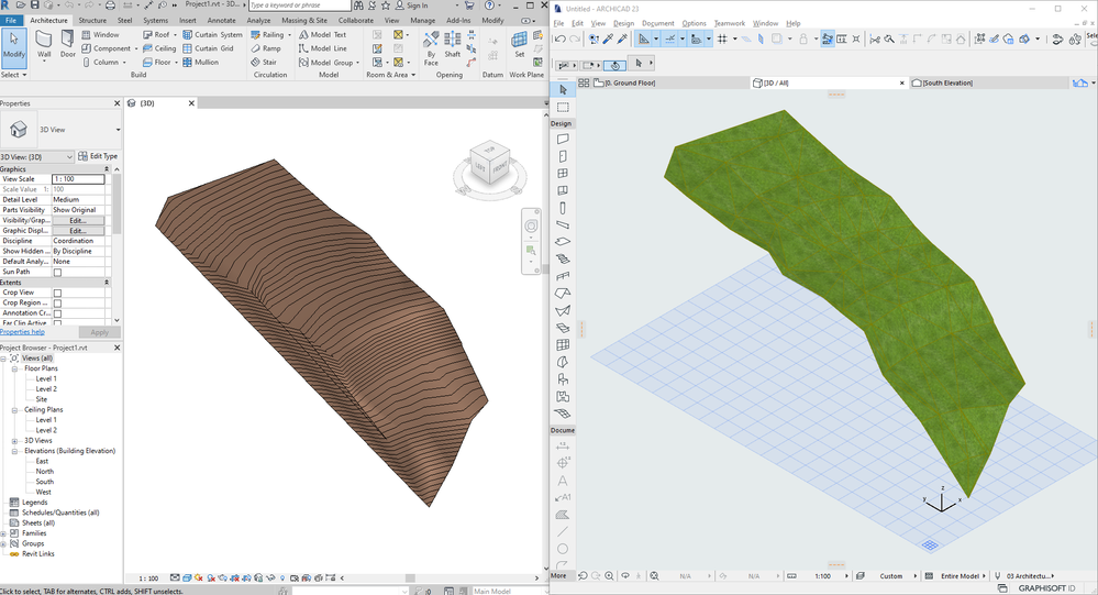

The project has large topography as it is an infrastructure project. All of them were created using Mesh object in Archicad. When a mesh is transferred to Revit via IFC, it is converted to a Model In-Place element, which cannot be edited easily. The Main Contractor requests for a toposurface to edit further in Revit.
This article will help you in re-creating an editable toposurface in Revit using the data extracted from Archicad.
The general idea is to export the points’ coordinates coming from the mesh in Archicad as a GDL object, and use them to redraw the toposurface in Revit. The boundary of toposurface can be modified using the mesh’s top view.

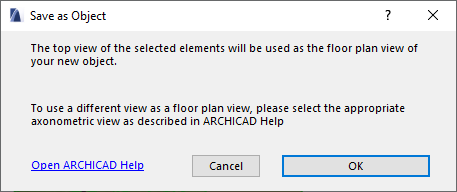

Notes: If the mesh is saved in 3D window, there will be a notice to choose the top view as the floor plan view for the saved object. Click OK to continue to the next step

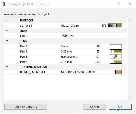

  • Click Save. In the next dialog, you will be ask to change some object’s basic settings. We can leave this as default and click OK. Now the mesh has been saved as a GDL object in the Embedded Library

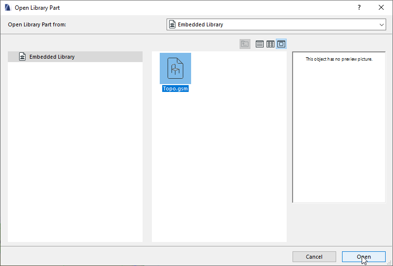

  • Open the saved object by going to File > Libraries and Objects > Open Object...
  • Select the GDL object created in the previous step and click Open

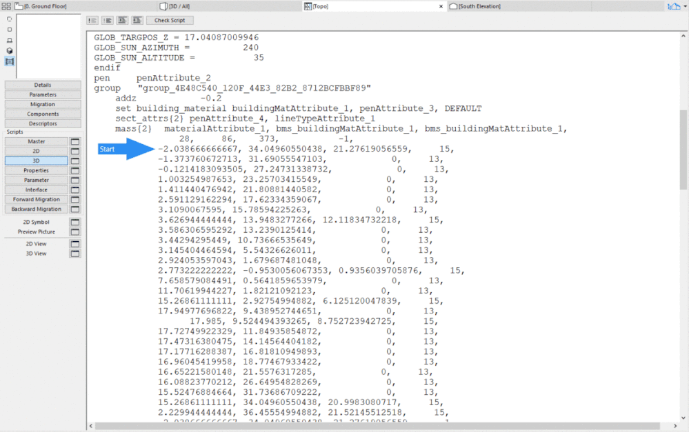

  • Click 3D on the left panel to open the 3D script

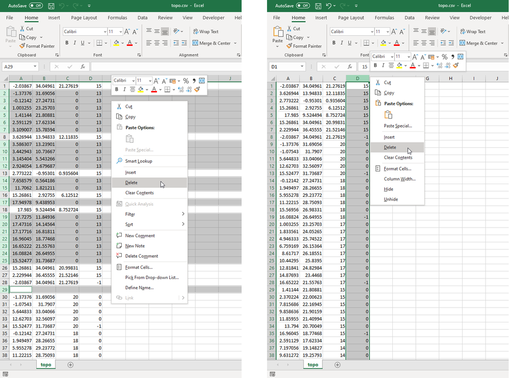

  • Under the line start with mass{2} you will find the list of coordinates in X, Y, Z format. Select and copy all coordinates (starting from the second line and end before line “base”) and paste it to a text editor (for example Notepad on Windows or TextEdit on macOS)

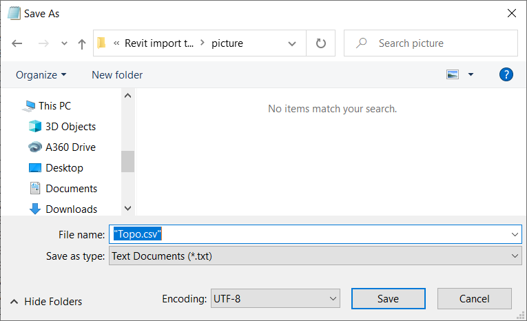

  • Save the list as CSV file (for example in Notpad, specify the file name in “ ” to save as CSV instead of txt file)
  • Open the CSV file in Excel
  • Remove any empty row or row with 0 in column C, as these are points at the base and will not be necessary for constructing toposurface in Revit. Remove unnecessary values on column D as well
  • Save it as CSV file again

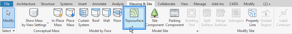

  • Open Massing & Site tab, in Model Site section choose Toposurface

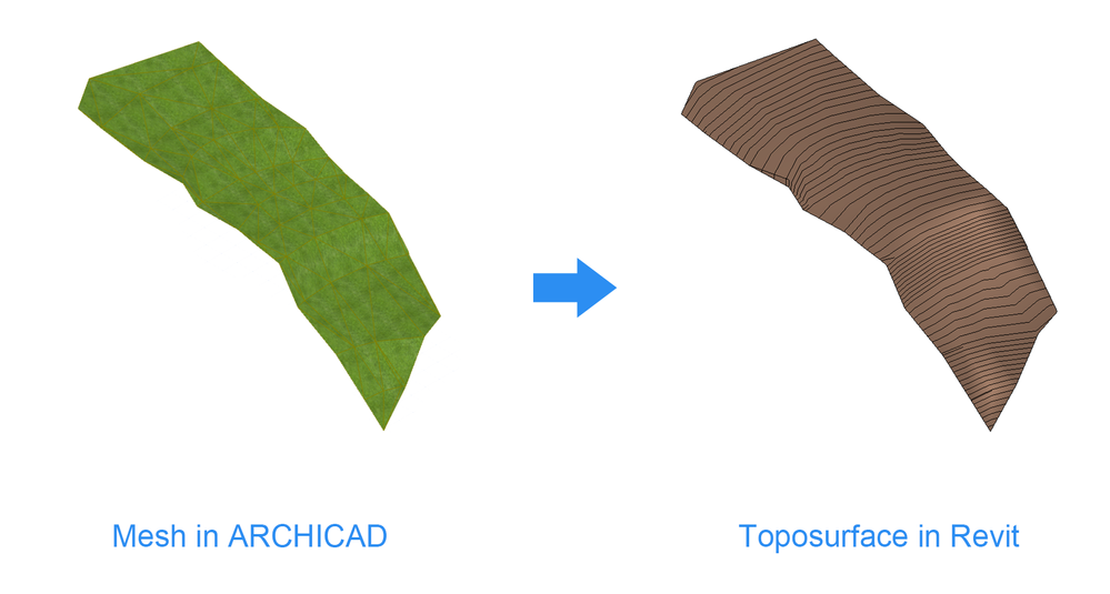

With some models, the process is finished here. But, due to how Revit contructs the toposurface (which is by connecting the most outer edge points to make the boundary), you may see that the new toposurface does not look exactly the same.
To match the look of the toposurface with Archicad’s mesh, we will make some small tuning by exporting the mesh top view to DWG, and use it as a tracing reference to modify the toposurface’s boundary.

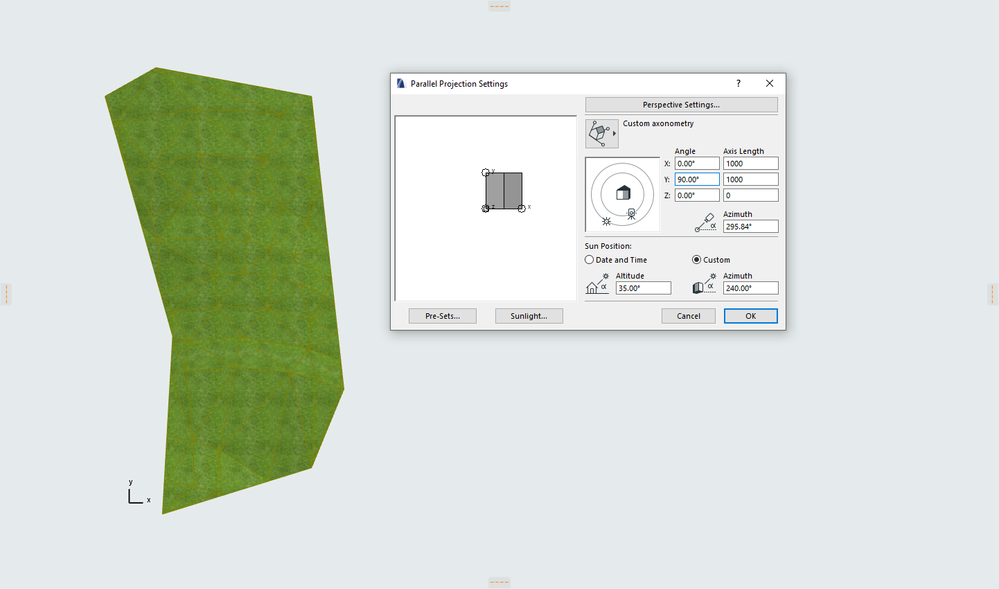

  • First, we need to isolate the mesh, in order to export only its outline from the Archicad’s model. The easiest way to do that is to show only the mesh in 3D. Select the mesh in the floor plan, then right-click > Show Selection/Marquee in 3D
  • Right-click a blank space, then choose New 3D Document from 3D. Enter a name for the document, and open it
  • Save this 3D document as a DWG file by going to File > Save as…, then select DWG extension under Save as type. We now have the boundary of the topography saved in DWG format

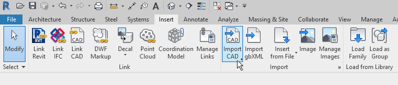

  • In Revit, on the Insert tab, go to Import section > Import CAD. Select the DWG file exported from the previous step. You can leave all settings as default, then click Open

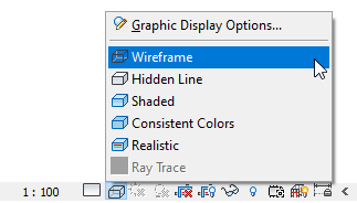

  • Change the Visual style to Wireframe using the View Control Bar, and choose Top view using the ViewCube on top right corner

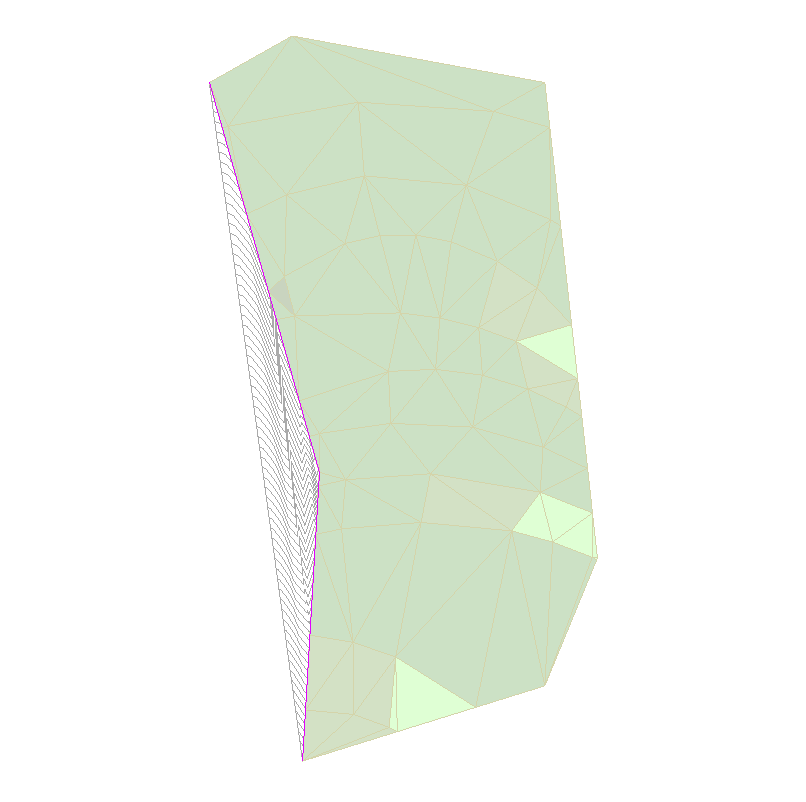

  • Go to Massing & Site > Modify Site > Split Surface and select the toposurface created in the earlier steps
  • Revit will enter sketch mode. Use drawing options to sketch the splitting line for the toposurface, which represents in pink (tips: Pick Lines option might help making the process faster)
  • Click  to close the sketch mode
  • Select the unnecessary portion of the toposurface and delete it. From this point, the DWG is not needed anymore and can be deleted
