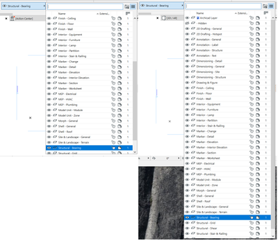

Improvements to the Attribute Palette
Attribute settings are now directly accessible using the Edit command from the attribute type folders as well. There is no need to select an attribute to go to the settings dialog.
Rename folders inline by simply clicking on the name without using the Rename command in the context menu.
The search has been improved in the Attributes Palette search bar:
  • you can use and/or between search terms
  • put the search term between quotation marks to look for exact matches
The teamwork status (editable) of the attribute types is indicated in the attribute type filter menu pop-up.

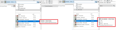

More information is available in the detail bubbles for Surfaces and Building Materials in attributes settings dialogs and attributes pickers. The info bubbles pop up faster than before.

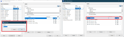

New layer creation has become simpler:
  • the new layer name can be given inline with no extra dialog opening
  • you can directly access the rest of the layer settings options (shown/hidden, layer intersection group number, etc.) in the same line

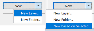

  • new layers can be created more easily as duplicates of existing layers using the New Based on Selected command
  • the new layer inherits the settings, including the layer combination settings, of the existing layer

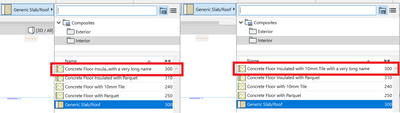

Improvements to the attributes’ pickers
Attribute picker width adapts to display the longest name without any user interaction.
Attribute picker height adapts to display as many attributes as possible, so users need to scroll less to pick the right attributes.
