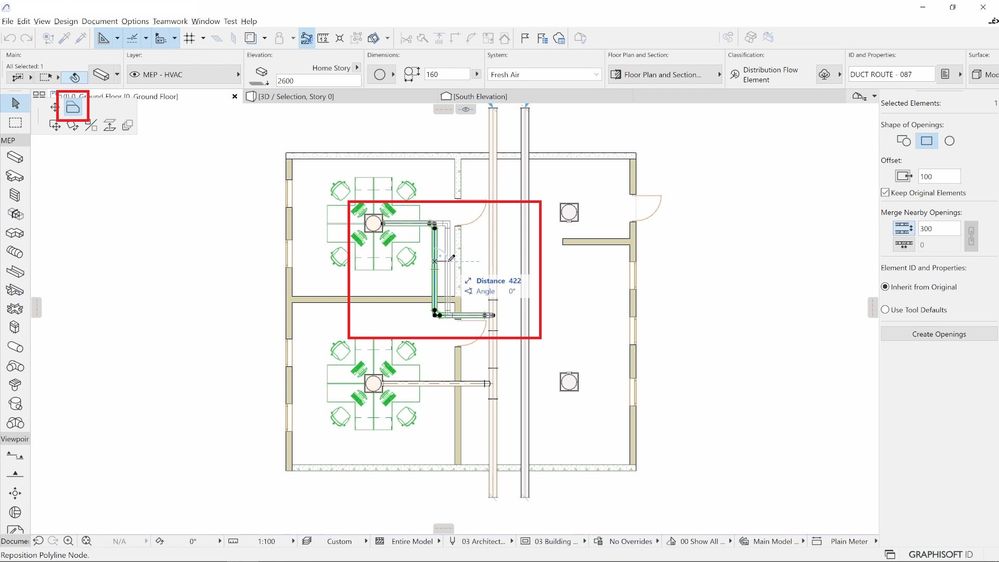

1. Offset segment command
For adjusting MEP elements, the new Offset segment command allows users to move segments of a route without affecting connected nodes, streamlining design adjustments.

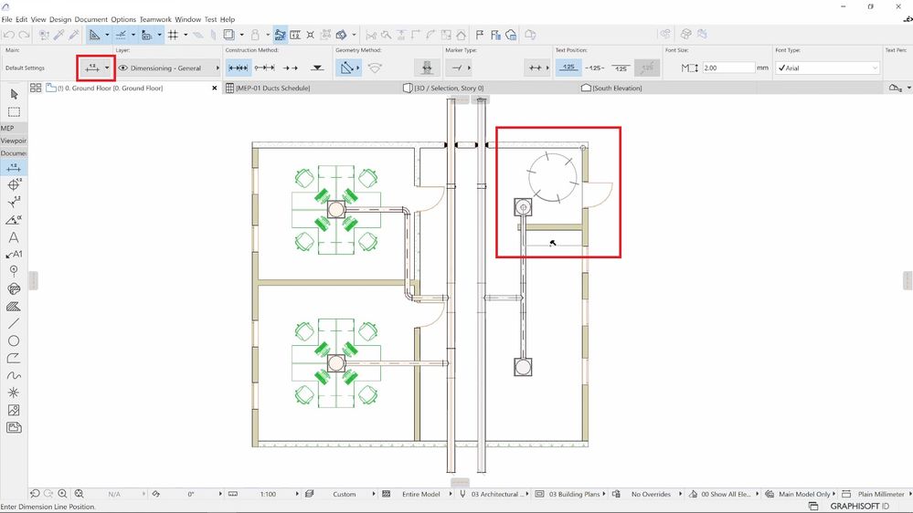

3. Associative Dimensioning for MEP elements
Archicad now provides Associative Dimensioning for MEP element hotspots for the accelerated documentation process.
