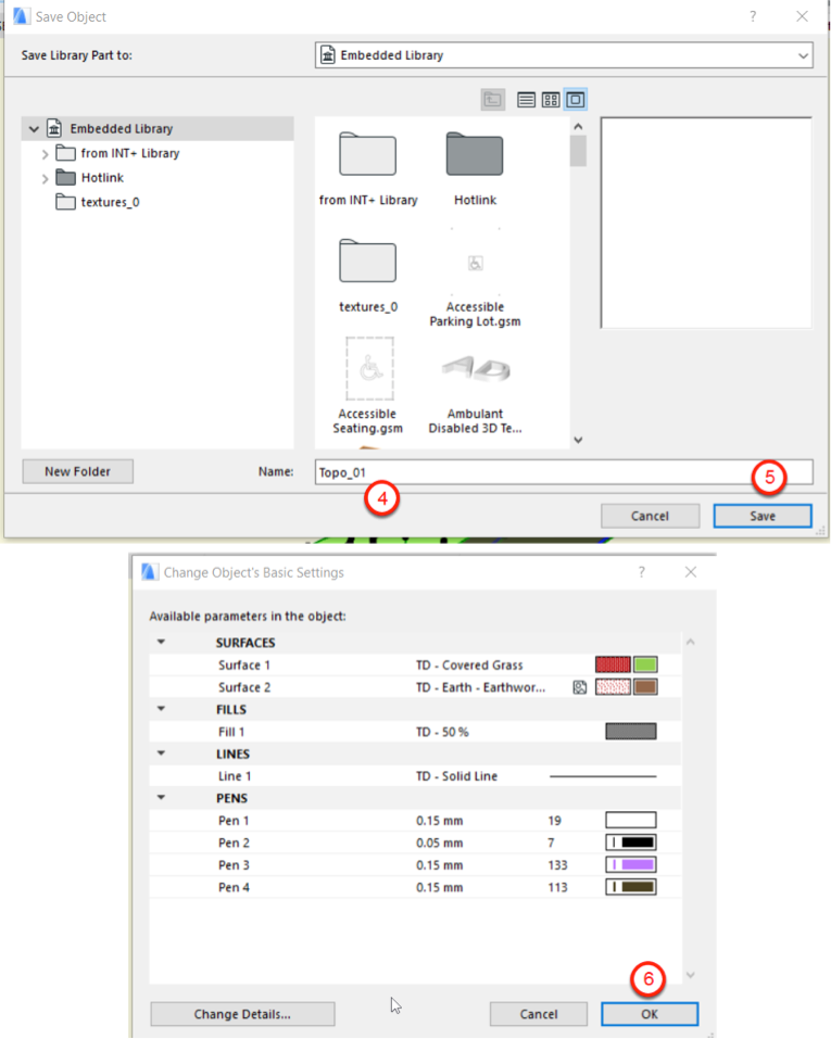

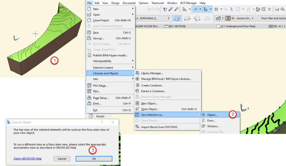

1., Launch Archicad and open the model, select the mesh (topography) in 2D/3D, right click and choose Show Selection/Marquee in 3D to isolate it in a 3D view,
2., Select the mesh and choose File > Libraries and Objects > Save Selection as… > Object…,
3., Click OK to choose the top view of the selected elements to be the floor plan view,
4., Give a meaningful name,
5., Click Save and
6., Click OK on the Object’s Basic Settings dialog box. Now the mesh (topography) has been saved as a GDL object.

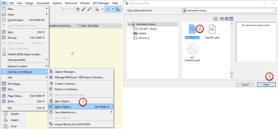

1., Choose File > Libraries and Objects > Open Object…,
2., Select the GDL object created in the previous step,
3., Click Open,

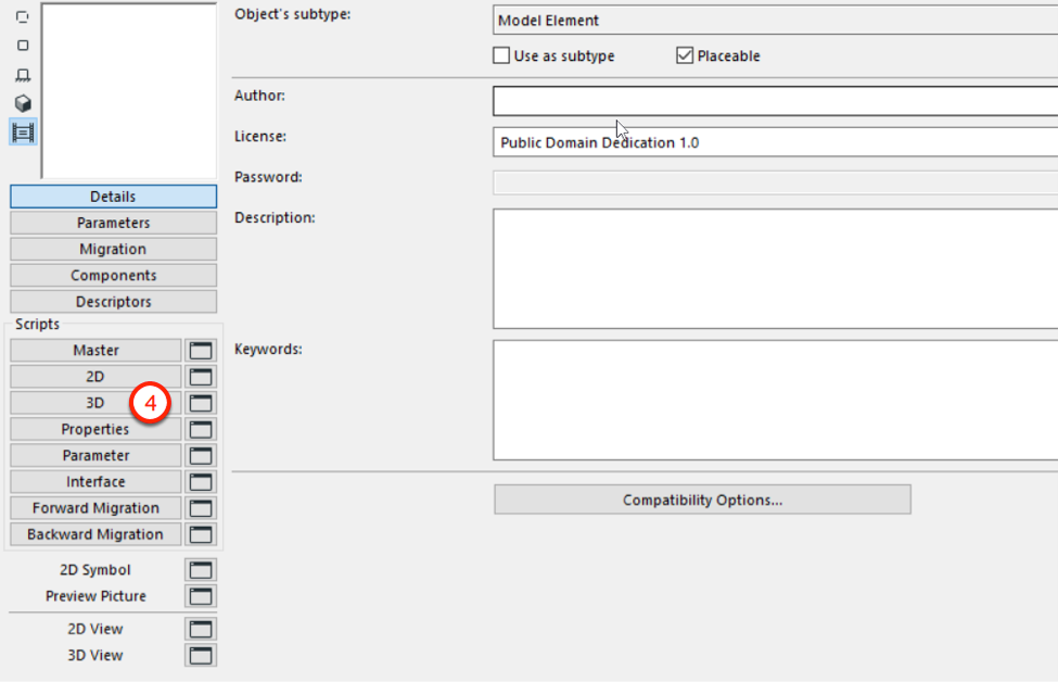

4., Click on 3D to open the 3D Script,
5., Look for mass{2} that comes with lots of points (X,Y,Z,Code),

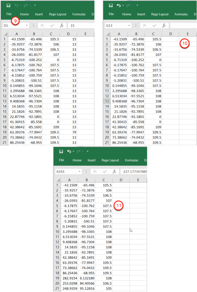

9., Open the CSV file in Excel,
10., Remove the Column D as it is the code used in GDL and not required for toposurface in REVIT,
11., Remove those rows that is empty or has the value 0 in Column C (Z axis) as they are the points in the base of the mesh (topography) and not required for toposurface in REVIT and
12., Save it as CSV file again.

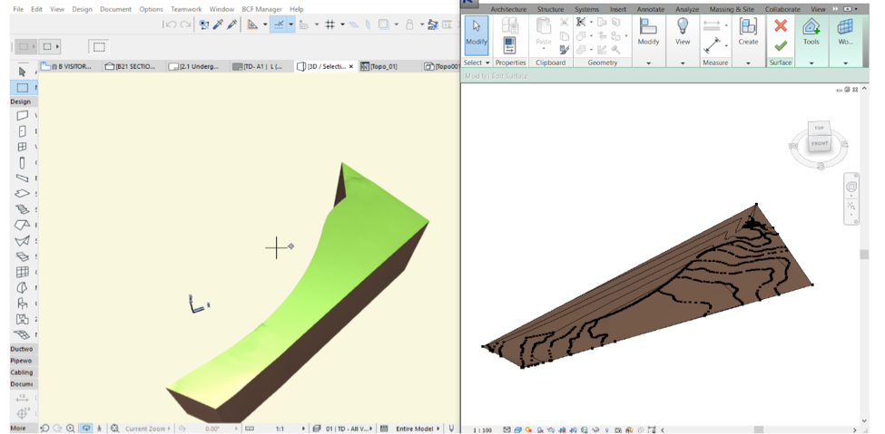

5., Click Finish Toposurface. Now you have the topography in REVIT.

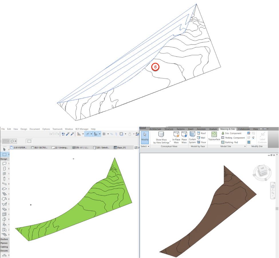

Switch to 3D window in REVIT to see the toposurface just created. When placed Archicad and REVIT side by side the topography do not looks 100% the same. It is due to the boundary of toposurface. REVIT connects the outer most edge points when creating the boundary. We need to go through one more exchange via DWG to correct the boundary.

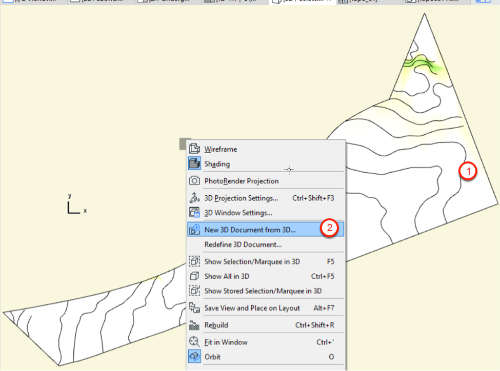

1., View the topography from top view in a parallel projection, (Parallel Projection Settings | User Guide Page | Graphisoft Help Center)
2., Right click and create New 3D Document from 3D… (this is to get a flatten 2D DWG),
3., Save the 3D document to DWG file,

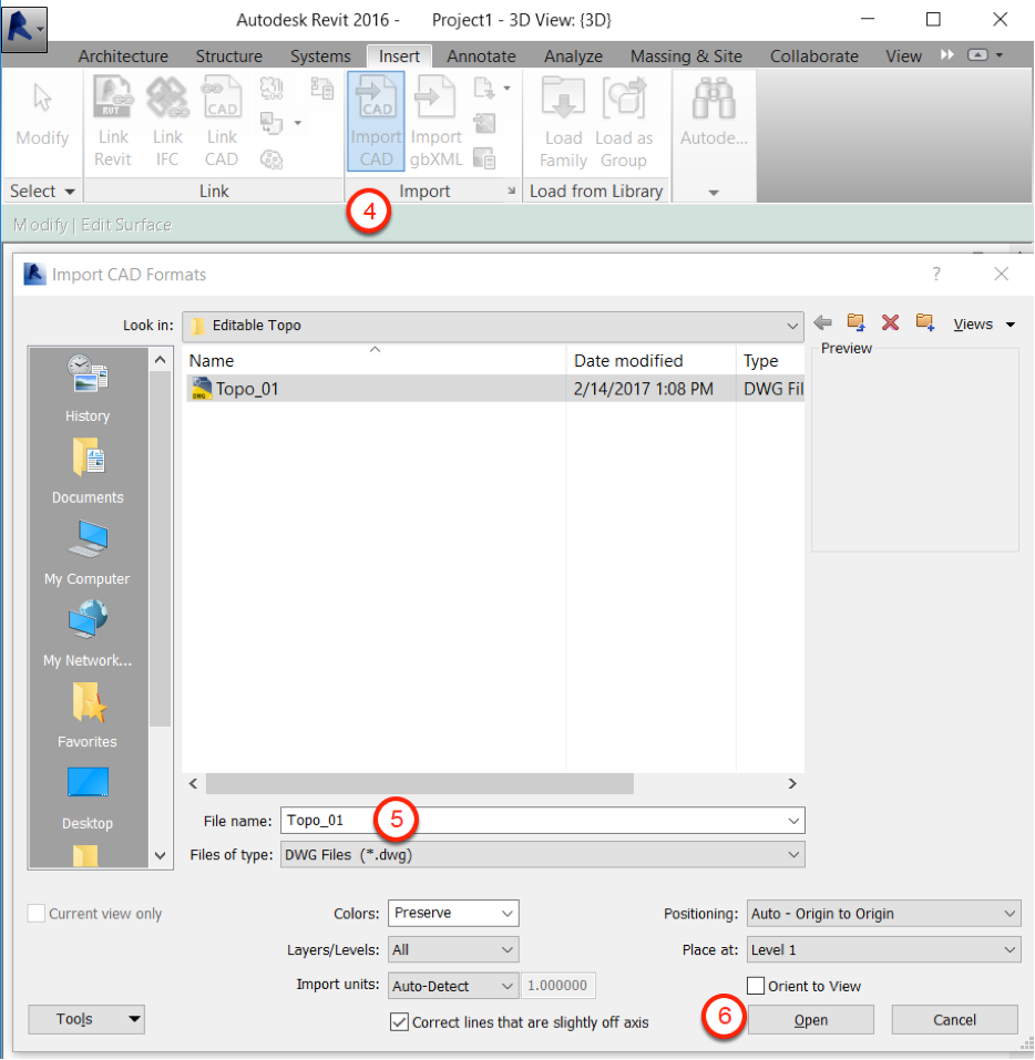

4., Import the DWG using Insert > Import > Import CAD,
5., Choose the DWG file exported from Archicad in the previous step, Just leave the default settings,
6., Click Open to place the DWG,

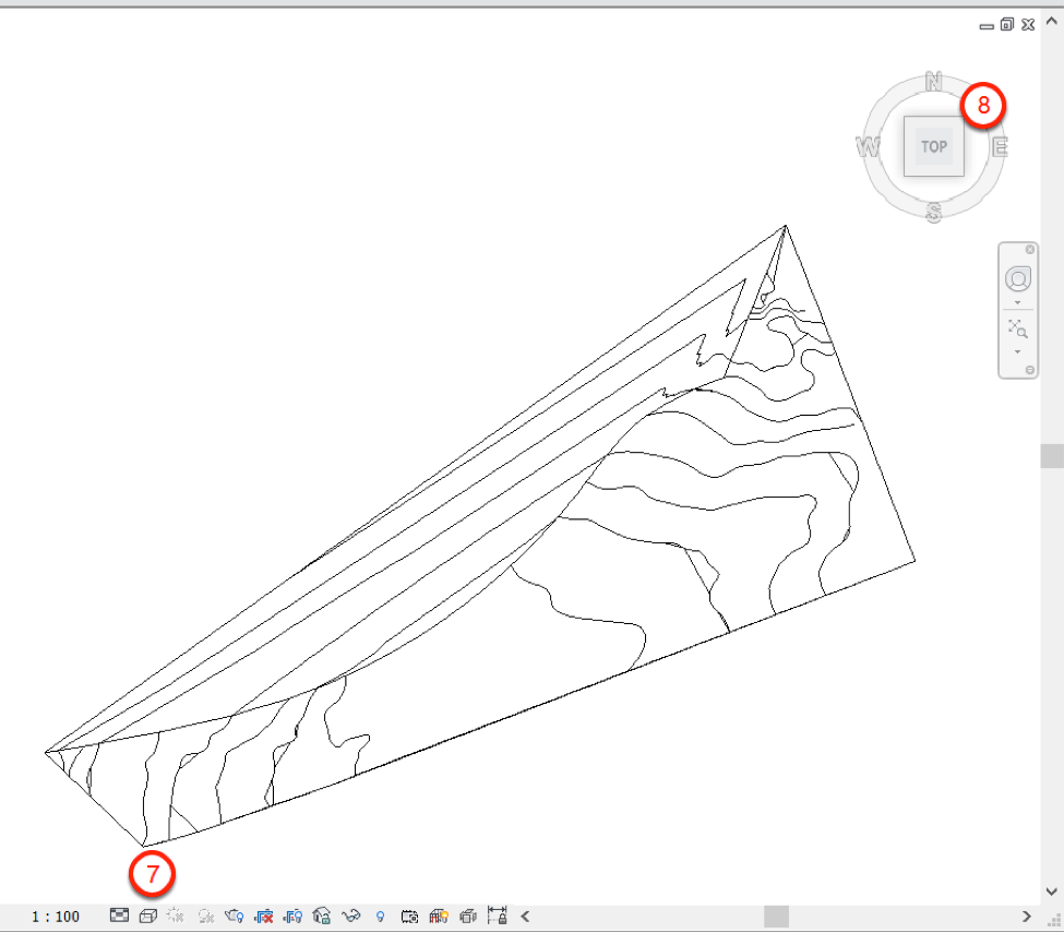

7., Choose Wireframe in the Visual Style and
8., Choose top view using the view cube, now can see the DWG placed exactly below the toposurface.

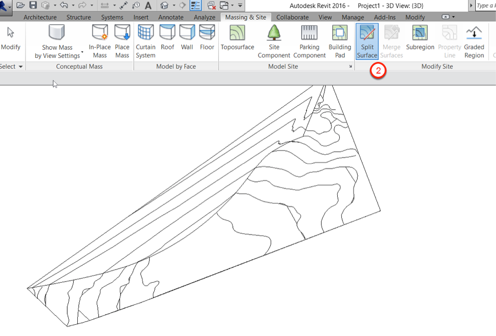

1., Choose Massing & Site > Modify Site > Split Surface and select the topsurface created in the earlier steps,
2., It goes into edit option, use Pick Lines option in Draw to trace the area that need to be deleted,
3., Trace the bottom curve,
4., Connect the edges with a line,
5., Click finish to close the edit mode (if there is error then need to fix it first before closing),
6., Select the portion of the toposurface that is not necessary and delete it,
7., Switch to 3D and switch back to shaded mode. Now we got the exact editable toposurface in REVIT based on the data from Archicad.
