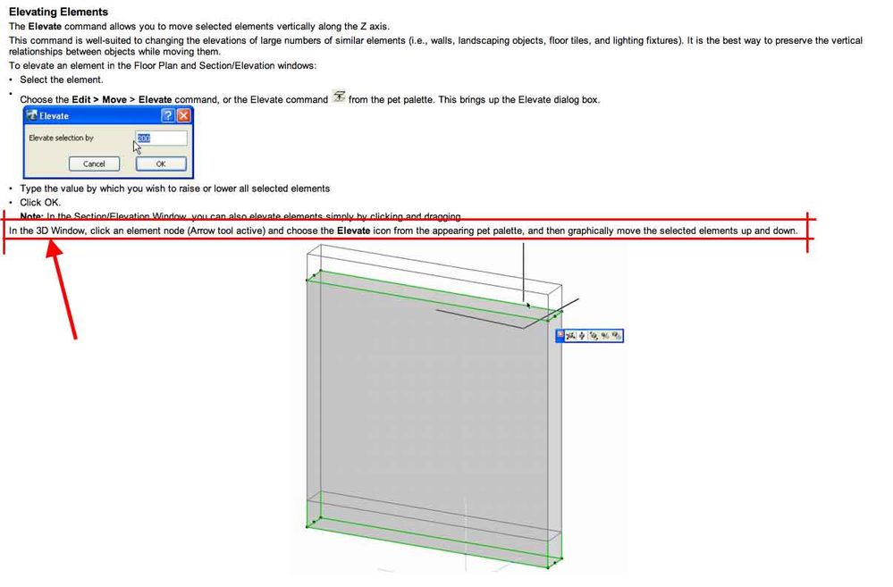

Can I elevate an object in the 3D window by inputting the desired distance?
I know I can drag graphically or input an Elevation (z coordinate). Tracker is on... it shows the distance I'm moving (elevation)... but I want to, for example .... elevate the roof 2'-3 1/8" by inputting that distance.
Is it possible?

Edit > Elevate or Command-9 (in my Work Environment, anyway)

That works in plan and section/elevations..... I'm in the 3D window.

It works in the 3D window as well. I do it all the time
Tom Waltz
I understand that you want to type the number actually. Here is the trick to do that:
Hit Ctrl+9 in 3D window
Hit Z type 0 enter
Hit Z again and type desired elevation.

I'm pleased to find it's possible... But it's not working for me.
Does the Elevate dialog box appear?
Could it be some setting in Work Environment that I'm missing? I can't get there via keyboard shortcut or the Edit Menu.
Do you have Tracker on?

Works for me. Tracker ON. Don't even have to pick a node.

I wasn't aware you could elevate in 3D window via ctrl+9 either! And......I have imtermittent results. For me it worked best, on a roof anyway by selecting it at the pivot line, ctrl+9, then z, input and it usually worked..........although I paid attention to what coordinate was highlighted, and I love this about 10, simply tabbing through them until I land where I want.
I have and will probably continue to use my tracker for this. [see attached settings] The moment an object is selected, and not before, tracker appears, then I tab through, input, enter and it's done. Frequently moving, or starting to move the object in the direction I want, i.e. up or down yields best results. as always multiple ways to skin that cat............

Does the Elevate Window appear? or do you input the distance in tracker? or in the Coordinates Pallette?

I've got the same settings as you. Still no go.
I can get it to work in a way, if I turn tracker off and type the value in the Delta R box of the Coordinates Pallette.... Or as I've done in the past.. switch to plan view and use Command + 9.
