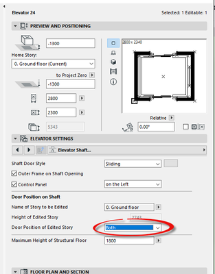

Hello, I couldn't mannage to create a second door oppenning on the opposide side of my first one.

This may be a bug that the developers did not think of or did not check.
I will report this to Graphisoft.
Try setting this option.
Yes, Barry, I think that is the setting we missed.
It works for me now.
