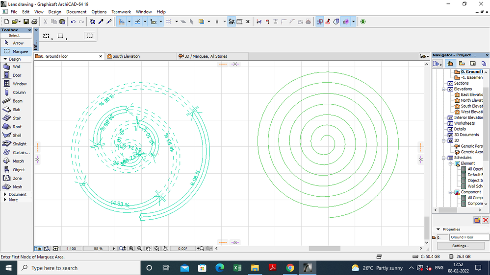

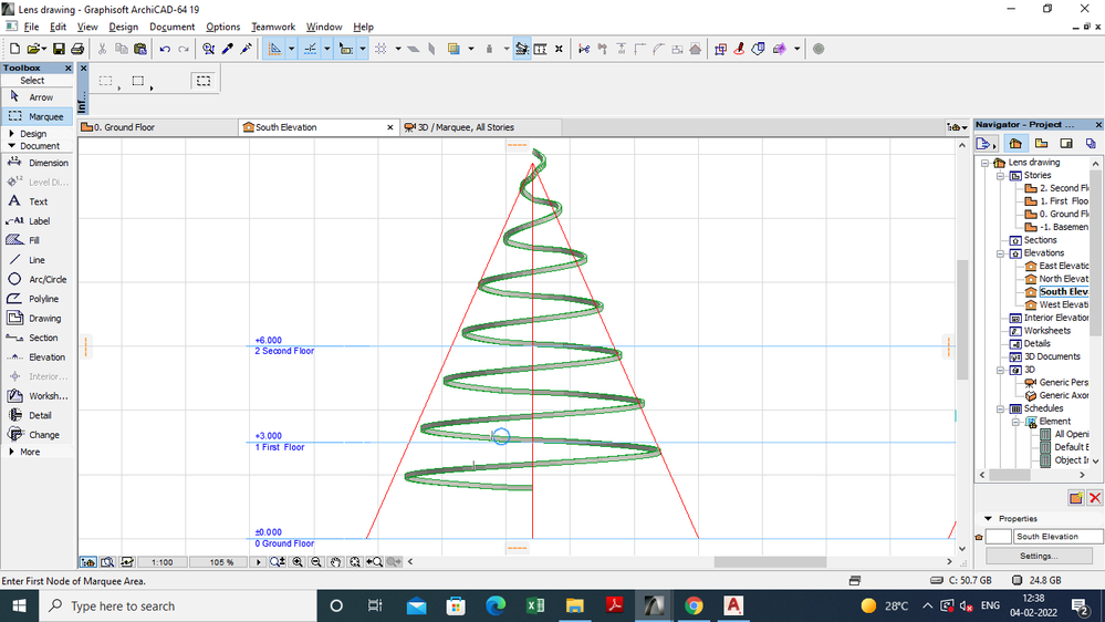

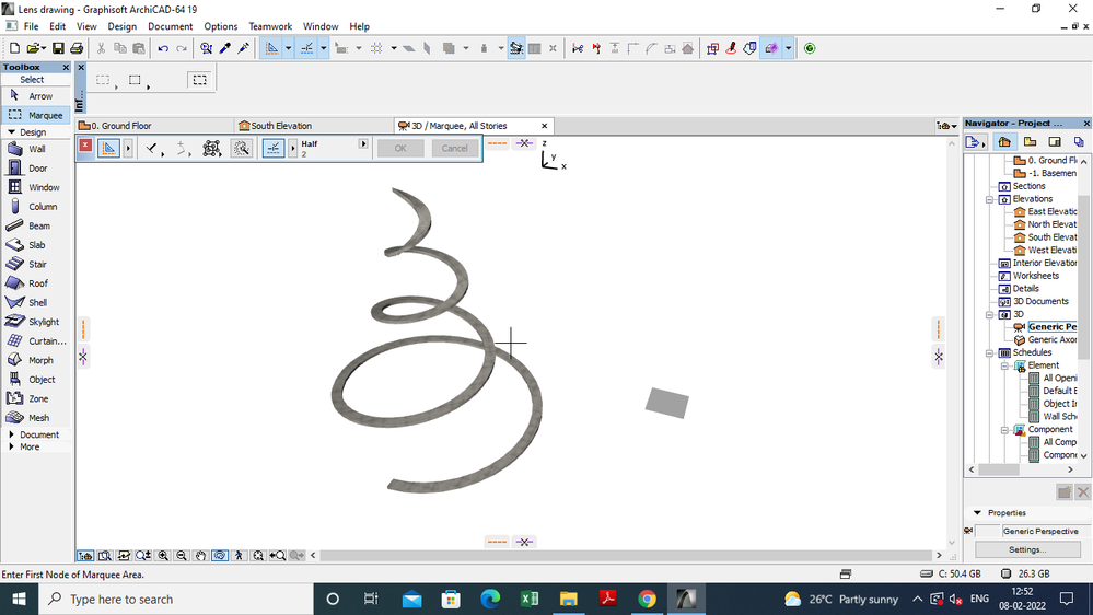

I need to create a spiral line to show in 3D the effect.
It should be seen like as spiral in plan and in elevation.
I tried with that Spiral beam, and curved ramp as shown in the Forum.
But in this, in plan it is showing as a circle, and in elevation it is on one side, in section it is proper spiral as  want.
I have attached the images.
And I have drawn the spiral in plan with morph, as attached image(screenshot 288,289), how to extude(for extrude I know we need a thickness) I dont want like that,
or make look spiral same as the plan in 3D.
It should be look like the image(screenshot 290)

Try this - its one of my GDLS and You can use a self drawn  profile-manager-profile within it.
https://bimcomponents.com/GSM/Details/23828
AC-Edu-File Aut version with example
Hmooslechner
A newer version - the german forum to download the latest: https://forum.graphisoft.de/viewtopic.php?f=6&t=26945&hilit=Rampe+harmonisch

Roopa A
Where do I get this object, to  download and edit for my project...
I tried using the above video,  and got this result, but it is not that smooth as shown in video.
I have attached the image below

Did you try to drag my object into Archicad direct  from the bimcomponents-link.?
In the GDL-Dialog, you can give it much more points - so it will look much smoother!  and - Its possible to "give in" much more than 360° into the dialoge to do this in just one "thing". This cant be made with the mouse - just in the dialog.
Roopa A
No, it is not importing,
I have AC 19, but the object is in AC 23.
So Yesterday I dint imported, now tried to import, but it is not importing
Roopa A S
AC 19 can not open/import AC 23 objects.
