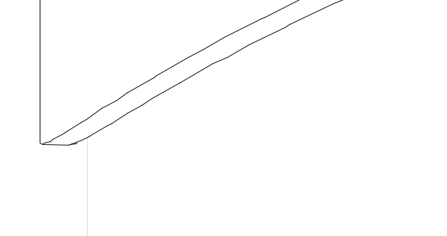

I have an elevation that I have unlinked from the 3D model, so that I can modify it and remove/add required lines that would normally look odd in a elevation.
I want to make these lines straight ( attached ) or at least erase then and draw on new ones. How can I erase part of a line and re-draw it, without deleting the whole component?

I would just draw a line perpendicular over what ever you want to erase and just use the trim tool.
You need to drag a copy of your elevation and edit the copy lines otherwise when you regenerate your section from the model the elements will be replaced and all your edits lost.
Re your 'line' isn't that really an arc?

Ok Thank you.
Is there a way in which I can rotate a section cut at all ? When I create a section through my model, it automatically cuts the lines at a 90 degree angles, however the components are each rotated at an angle of 12 degrees.
The image shows that parts of each segment is not visible to the the angle. I though that if you can rotate the section cut, it will counteract the angles and make a straight cut. I'm referring to the arc part of the section... if you follow it round you can see where the majority of the model is missing.
A suggestion was to draw over the lines to make each one join, but not all lines are visible so it's particularly easy or accurate to do so.
