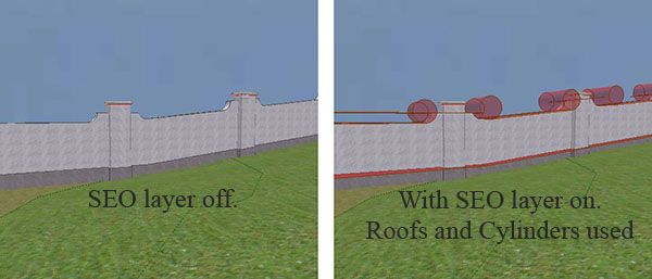

I'm working on a garden wall per attached photo. Used SEO so far. I need to create a stone wall coping wall cap contoured to this wall profile As you can see I've used a bunch of roofs and cylinders. I'm dreading having to cut the top and bottom of the cap. Ideas?
Thanks for any thoughts.

A two part answer:
the basic wall:
a complex profile made as a beam, because beams tilt without distortion. foundation and upstand all in one.
The goofy top trim bits: I'd also make these as a complex profile and stick them on top. These go ACROSS the beams.

Thank you Dwight and Srinivas for the very prompt answers. Dwight's two part solution fits well for the coping stone in both curve and the fact that wall changes slope with grade.

OK, the original question was how do I make the coping. Per the photo's I've already made the wall. Very nice suggestions on the wall by the way. Here's what happened when I made a profile to go over wall that has been SEO'd. See attached. I tried to use the new coping profile as an SEO operator, but that is a non starter.
Also look at the bullnosed post cap, can I profile the forward edge of the coping to have a nice bullnose (or other) shape? The coping is a cast concrete "limestone".

Relative priority numbers cause touching elements to cut. Increase the priority of the cut element to stop that.
In your case, even though you've only asked for the coping, an efficient solution would use the complex profile to make coping AND wall at once, stopping at the part you call gooseneck. Make the columns include the gooseneck part using my prior method of a cross piece complex profile.
This will modularize and simplify the job.
Any complex profile can bullnose. As for a "cap," I would make it a four sided complex profile from a wall extrusion.

(edit) PS For anyone following this: once the priority level of the beam is raised, SEO works like a charm. RE-EDIT, of course I still can't angle the beam profile along its width, oh well.
