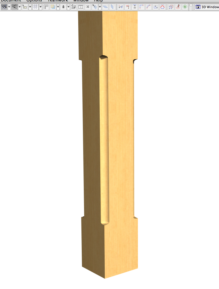

A year ago we used the Morph tool to make an SEO to acheive the result shown. Unfortunately ,due to my broken brain,the Morph wasn't saved and is long lost……:oops:
I haven't been able to repeat the method used to get the morph shape required!
Does anyone have a method that works for this or are there videos out there.
I noticed in one of Jared Banks' videos (https://www.youtube.com/watch?v=dTxhG4z-iUk) he has the same effect.

FWIW, I used the rotated complex profile as an operator in the video of mine that is referenced.
Morphs are great, but if a form can be created without them, it's almost always easier (these cut outs are a case in point).

Also, with priority junctions and Building Materials, you don't need to even use SEO, if the rotated CP has a higher priority (also no need to turn them into morphs).
