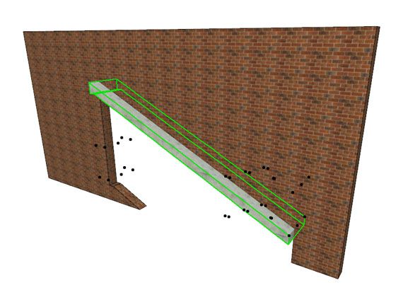

Hey.
I've found Solid Element Operations very handy to make elements "fit together". However, I've recently had some problems with the downwards extrusion option available.
When using a sloping ramp as an operator and a wall as the target, the idea is to trim either the head (with upwards extrusion) or the base (with downwards extrusion) of the wall to match the slope of the ramp.
Upwards works excellently, but with downwards some weird problems occur. The base of the wall is trimmed, but only for a certain height - then it reappears!
This leaves a wall in two pieces (though technically the same wall) with a sloping slice through it. Very annoying and utterly useless for my purpose.
If required, I'm happy to post a screenshot later.
Thanks for all and any help!

Screenshot would help us. I've not had a problem like you describe.

Screenshot is attached where you can see how the wall is not extruded correctly.
Another strange thing, is its reaction if I elevate only the wall above a certain threshold in relation to the wall - the SEO then behaves more like a simple substraction without any extrusion downwards.

I can't reproduce the problem either. What object are you using to form the ramp; a library part, or a complex profile applied to a beam? Is there anything else on hidden layers that could be causing the effect?
I presume you've tried selecting the ramp and clicking the 'Cancel Operations of Selected Elements on all Targets' button, and then redoing the SEO?

That is strange. I've used the stair tool > Create stair, and selected ramp from the tab. Cannot think anything that would be causing the problem, as I've reproduced it several times after cancelling and with other walls.
I guess SEOs can be a bit troublesome some times, but I've found a workaround I can use by making the wall start way below ground - thereby the untrimmed bit is too low to be of any trouble.
Btw, i'm using educational ArchiCAD 14 on a mac with snow leopard, if that matters at all.

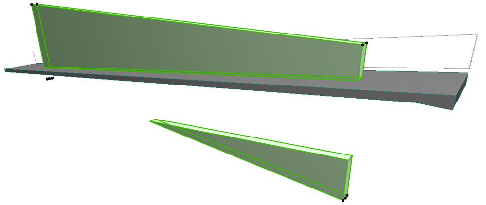

I can confirm that something strange occurs when using a stairmaker ramp and downwards extrusion. The image below is in AC13.
As a workaround, try using a piece of roof angled to the same pitch as the ramp to trim the wall. You can put this on a different layer and turn it off to hide it. You could even use a rectangular piece of roof instead of a ramp altogether depending on what you need!
