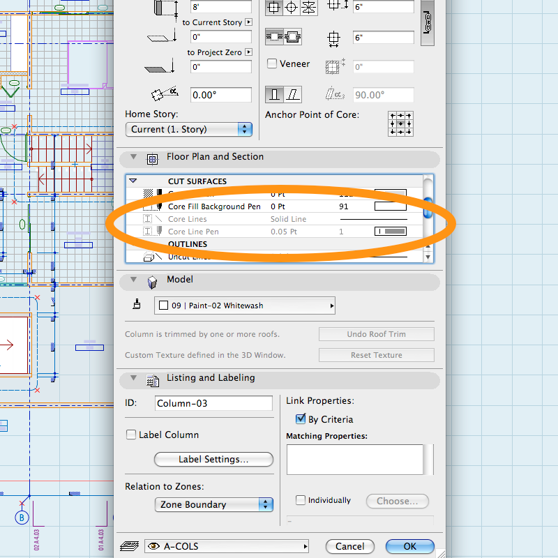

If you decide to place a Column the setting for the Core Line Pen (color and line type) can not be edited until you select the Custom profile option and uncheck "Apply Structure Settings".
Is there a reason why the settings for Custom affect the Rectangular and Circular Options?

Selecting the Custom Profile Option, the only place to edit this option.

Eduardo Rolon
Now it is editable.

Eduardo:
I don't know how you got this behavior, I cannot reproduce it.

David,
I just tried to reproduce it and I can't. I originally saw this behavior in the computers of one of my students and then I was able to duplicate it on my machine. Curiouser…
Could have been a library issue?

ejrolon:
I don't see how the libraries would affect a tool that does not use library parts, I would be more suspicious of a Complex Profile. Or maybe the computer just hiccuped.

David,
I agree that the library should not be the culprit but the reason I listed it was that that is what changed after I took the screen shots. Before the update I was able to duplicate the problem.
The hiccup occurred in two different comps, one windows one mac, both using the same template file for the project. So your theory of a complex profile being the real culprit sounds more reasonable. I'll see if I can get the error again at the University Lab.

I encounter this every time I use the GRID SYSTEM TOOL.

Eduardo,
This was a bug in the US template, which was corrected in the build 2420 Hotfix#3. (The most recent Hotfix is #4, build 2523). Your student's ArchiCAD was probably not up-to-date.

Greg,
That makes more sense.
