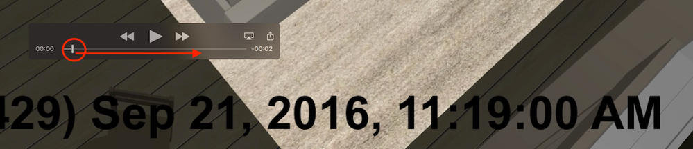

Marcus wrote:
I know that there is the sun study option, but this either spits out a file or files that we don’t need, or displays on the screen with no way of pausing to look at a specific time.
Assuming you view (a saved) sun study file (.mp4) using Quicktime Player:
Instead of clicking the "play" button, drag the slider.
You can move frame by frame and see the time change in the subtitle text.
