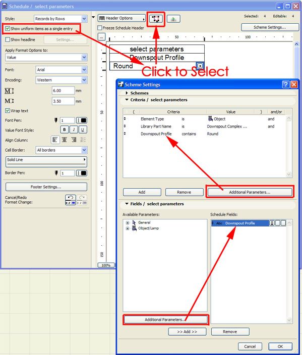

Now, is their any way to select all the objects that have a certain value for a certain parameter?

Cleverbeans wrote:Not by using Find & Select, but you could use a temporary Interactive Schedule to list all the objects with a particular parameter name.
If you tick 'Show unform items as a single entry' then press the 'select on floorplan' button, all of those objects will be selected at once!
See attached image.
