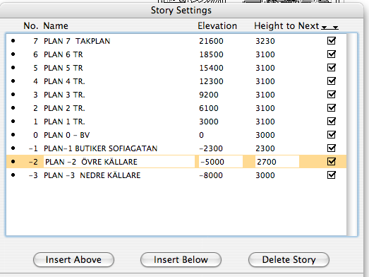

Yes, ok. But where do I change the story numbering for the template?
Thomas Holm
Design >Story settings. You change the name of the story to whatever you like. In this case, story #0 is PLAN 0 is the entrance = street level.

I know but in the version I am using there is a -1, then a +1 +2 +3 and so on but no 0!!!! This is my problem. I would like to have a story numbered 0...
Thomas Holm
Weird. Never had that problem. Maybe someone deleted Story 0?
I would just try to insert a new story below +1 (or above -1) and see what happens. Then you could copy everything from the relevant story to the new one. Look out for height issues, though. First work on a copy of your file. Story manipulation isn't always undoable.

the USA version has no storey 0 ("Story" 0 even) in its template. ask someone with the USA version to zip and send you the default template: see if that works. if not, it must be hard-coded into the actual localised version of the application. talk to your reseller . . .

This is hard coded into the program and is one of the only differences between the US and INT versions apart from Attribute/Library issues, if not *the* only difference.
Either way, it shouldn't affect your work. When you take the project between the two versions, this viewpoint ID should change seamlessly.
