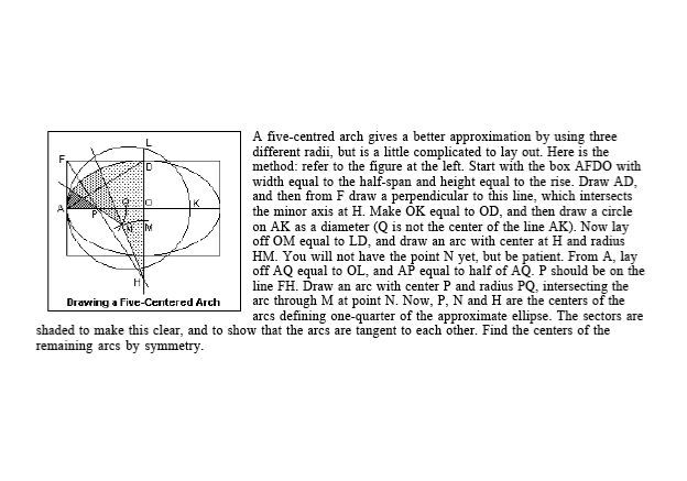

Hello,
Can anyone direct me to a description of how
to draw a five centered ellipse ?
I understand this is not a true ellipse but
is sometimes called an ellipse.
I found this on the web (see image) but
I can't get it to work. When I get to the
step where it says that point P should be on line FH
it isn't. I have tried several times to follow these
instructions with no success.
I am hoping someone can direct me to a
better set of instructions for drawing a five centered ellipse.
Thank you,
Peter Devlin
