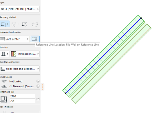

Can anyone tell me why with AC28 the flip wall shortcut no longer works?
Operating system used: Mac Intel-based

The default key became F.
You can change: Options - Work Environment - Keyboard Shortcuts. All commands and search for "Change Flip Status".

By shortcut, do you mean keyboard shortcut?
The button in the info box works as always.

In AC27 if I had a wall selected and pressed P it would flip on the access line. Currently nothing happens.
