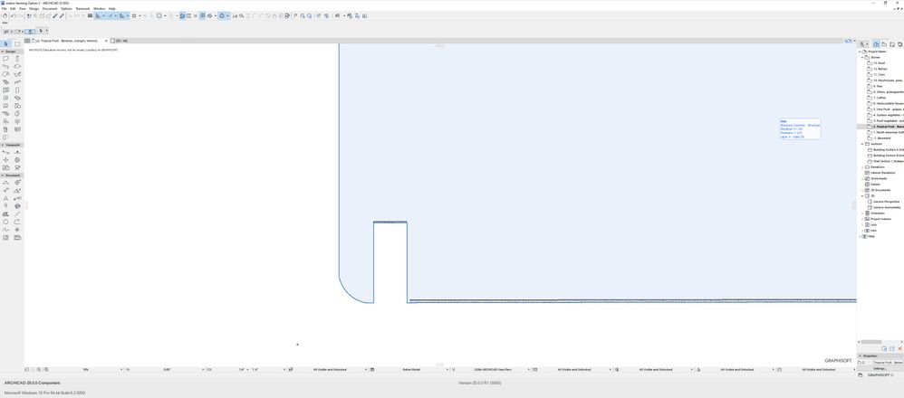

I am designing a multi floor building. The building has walls and columns that start on the lowest floor and terminate at various floor. When I place those items and set the layout to show the items on "all stories" or "all relevant stories" I would expect to see those components on the various stories but I don't. Never had this problem before. I am using AC25 (5005) USA. Can anyone tell me how to fix this issue or is this a need to uninstall and reinstall (really don't want to do that). I am also using the most up-to-date version of Win10 Pro.
As an example, I have a wall that starts in the basement and terminates at the top of the second floor. When I select the basement floor plan the wall is shown but when I change to the first floor floor plan the wall doesn't show even though I set it to show on all stories. Thanks in advance.

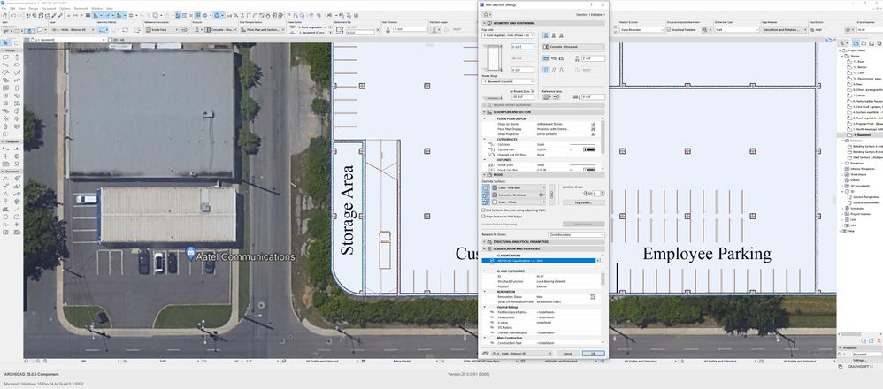

I looked at the settings and everything looks right to me. Here are some photos to show the settings and the floor plans. Maybe you can see something that I missed. Thanks.Highlighted wall and settings.jpgStory 1.jpgStory 2.jpg

@wile e coyote genius The strangest thing I can see in your images is the quick menu setting at the bottom of the screen are mostly showing "All visible and unlocked". Typically these would display as more obvious names relating to the pen set, MVO, GO, renovation status & dimension style. Have you renamed these items from the standard template setting?

Hello all. As requested I have attached higher res pictures below. You should be able to zoom in and read the text in the properties menu. Also I have added a 3D picture showing the wall and how it shows on all 3 stories (stories 1 & 2 visible). As for the "Quick Settings" menu across the bottom, I didn't know what that was and never looked at it. What is shown I figured was the default settings. After quickly looking at the various buttons and their options I am going to have to read what they are and how to use them. So as shown previously the wall does not show on stories 1 & 2 in the floor plans but does show in the 3D view. Still stumped.

@wile e coyote genius Ok so next best guess I see some of your upper walls are visible so I have narrowed it down to you may have a cover fill applied to the slab which is masking the walls. Can you try changing the display order on the floor above to bring the missing walls forward - Edit > Display Order > Bring to Front or send the slab backwards and see if that fixes it.
This looks a bit like a bug as I created a wall on the basement storey then added a slab on the ground floor and it was displayed ok, but if I then turn on the cover fill the wall becomes hidden even though it is extended above the slab. If you go to the next storey above where the wall is present it displays correctly.
For now it looks like you may have to manage your wall display order manually or avoid using the slab cover fill.
This needs a bit more investigation as I'm unsure if it works this way in previous versions or if it is a new display problem.
Hello DGSketcher, I tried the "fill" thing but no luck there. So I then tried the build order command and pushed both slabs back and that worked so far. The only down side I see is that now I have to push back all of my floor slabs. But that brings a new question, How does one set the build order? My thought would be that the build order would start with the lowest item on the floor and then adding those items that are above that point based on the height of the object and lastly those items that show on the story but start at a point below the current story. Any suggestions?
