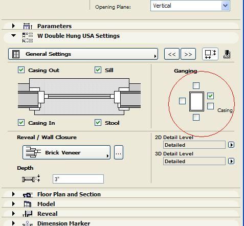

Ganging WDW's in AC12
Used to in 11 you had the ganging option in the window dialog box with how wide you wanted the ganging to be.
In 12, that ganging selection box is still there but no size of the mull you want. Is it located somewhere else or did they do away with that (hope not)

Just to back this up....here's the AC 11 Ganging option JLKilgore is talking about.... I use this a lot too, it would be unjust to do away with this option in future versions of AC....

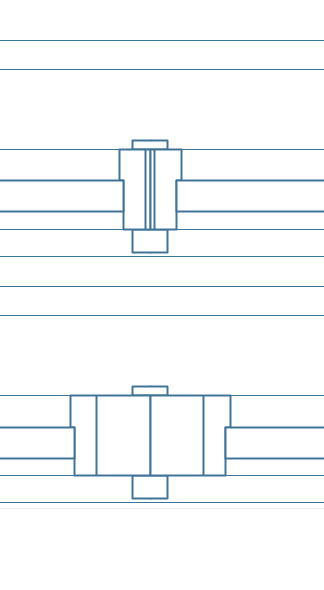

This parameter seems to do the same thing for me as the 11 parameter, although the location is less convenient.
See the attached screenshot. Two W1 Casement 12 windows are ganged with default settings on the top. Changing the 1/4" 'tolerance' to 3" did change the framing/mullion space to 6" overall.
Visually, there is a joint line where the two window meet. This line is absent in the 11 symbol, which I prefer, since one may have a solid framing member in that space.
So, I think it behaves the same as the old param - but the result is not visually correct? What do others think?
On a related issue: by cutting through the casing, the UI suggests that the casing should have been stretched, too, but it is not. In fact, I cannot find a parameter i that will let me make the ganged casing a different width than the other vertical casing. Does anyone know how to accomplish this?
