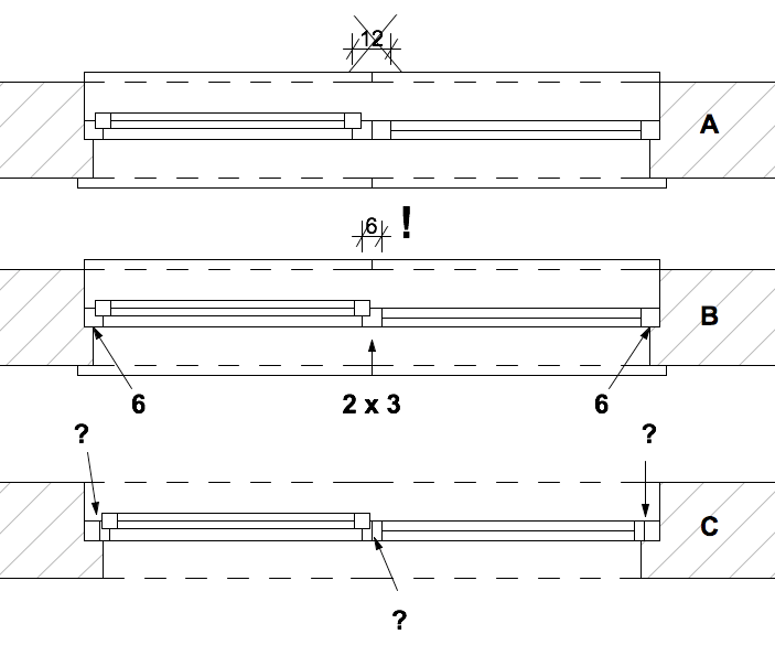

Despite the need, I can't achieve two ganging windows with a single post in between (situation B). I need it on regular basis.
I've tried in AC12 : window frame of 3 cm + spacing at reveal (situation C).
So I get a correct 3D representation but the inner lines in the 2D window frame are absolutely not done!
Why didn't you GS add the option "custom window frame width" instead of uniform width? This would help a lot and not too difficult to achieve.... I guess
See picture.
I guess I'm the usual moron, but perhaps someone could clarify this to me:
While AC12's behavior might be inconvenient in some cases, I find it more logical and correct than AC11's. If I interprete your request correctly, you (and Karl) are trying to construct one W2 casement window by ganging two W1 casement windows. I find AC12's refusal to remove the joint line quite to the point, if ganging/combining of several windows with individual frames is wanted.
If, on the other hand, this feature (like some seem to do in AC11) is used to construct a multi-sashed window, with one (common) mullion (frame part) between any two sashes (Joeri's situation B), don't we need other parameters instead? Not only a switch to remove the joint line, but also a width parameter for common mullions (which normally differs from the outer frame dimension), and perhaps more, like different dimensions for vertical/horizontal etc.
Seems to me you're actually asking for a Windowmaker! But that's a third-party option today, or you'll have to use the AC11 storefront, or something else.
And, if you just want 2 sashes, why not use the W2 window?
Also I can't see the problem with putting a structural member between two windows. I do that often. Naturally, they're not "ganged" anymore, but you can always group them, etc etc.
Please explain this issue to me!
How I used it on a daily basis at the firm I worked in was that some designs called for a skinny mull in between the windows (1") and some thicker (3"-6") depending on what the designer wanted. (residential)
We had several people try to figure out a new way or different way to get the same effect but never could get it to work or mesh as smoothly as the option that was available in AC11. Sometimes we have 4 and 5 ganged windows and may specify that in between each window there be a 3" mull. Before, I just specified that the ganging be 1/2 that width and VIOLA it meshed with no snags what so ever. Brick sills and soldier headers all meshed correctly.
Just don't know why somethign that was so handy, and now that I have posted this, widely used was omitted when it worked like a charm to begin with.

Thomas,
Of course it's not about the W2 Casement window in particular... The picture shown is just a rough representation. In fact it's about combining whatever window in the AC library with another one to achieve more alternatives. No need for more AC window types. Isn't that what's ganging all about ?
I hope the next image will clarify.

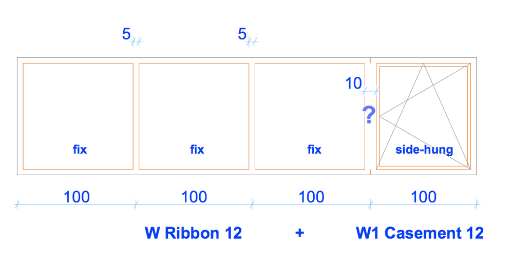

For example, try a window with 4 equal parts and one side-hung...no extra structural member needed.
Daily practice
