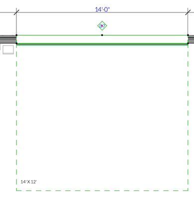

Is there a trim that I can add and have show (red) for Garage D1 01 27?
(& still have the garage door read 14'-0" for the Door Schedule)

I cannot see which library part object your are using exactly, but maybe you could play with its settings changing the dimensions of the frame and also the wall reveal type.
Also you could increase the detail for the door Floor Plan Symbol in the model view options.
