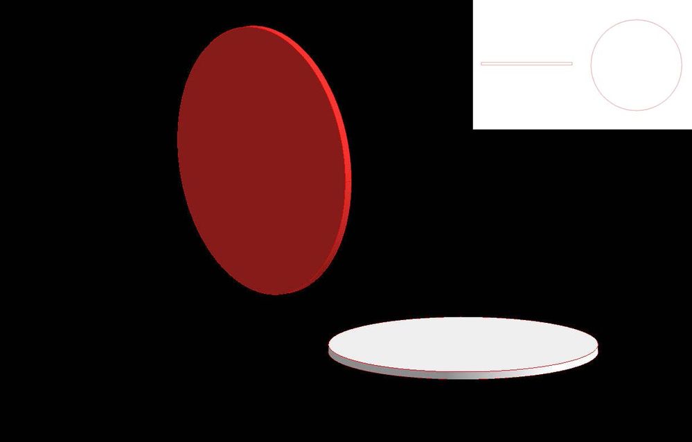

Select the slab and view it in 3D. Go to File > Libraries and Objects > Save 3D Model as ...
MacBook Pro Apple M2 Max, 96 GB of RAM
AC27 US (5003) on Mac OS Ventura 13.6.2
Started on AC4.0 in 91/92/93; full-time user since AC8.1 in 2004
Laura Yanoviak
Save the object to your Project Library. Select "Object" and "Editable GDL Script" from the dialog, click OK. Insert the new object into your plan, the result is below (plan view in upper right corner).

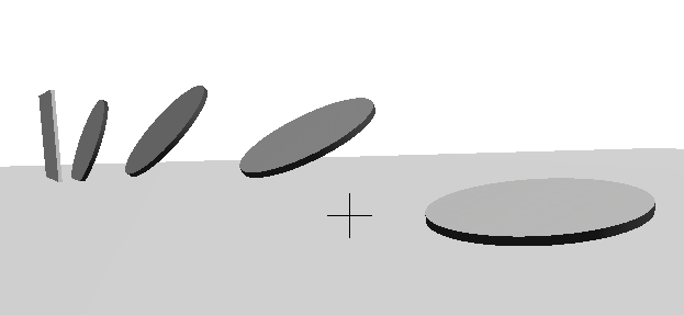

I see that OBJECTiVE has already been recommended to you. To clarify, it will allow you to rotate and split any GDL object in 3D and place hotspots on the 3D body for easy snapping.
It won't currently rotate any geometry, e.g. walls, because ArchiCAD doesn't support that kind of transformation. Slabs and roofs, however, can quickly be transformed into 3D objects with OBJECTiVE's profiling tools, which can be rotated, split, and bent in 3D (see attached image)
