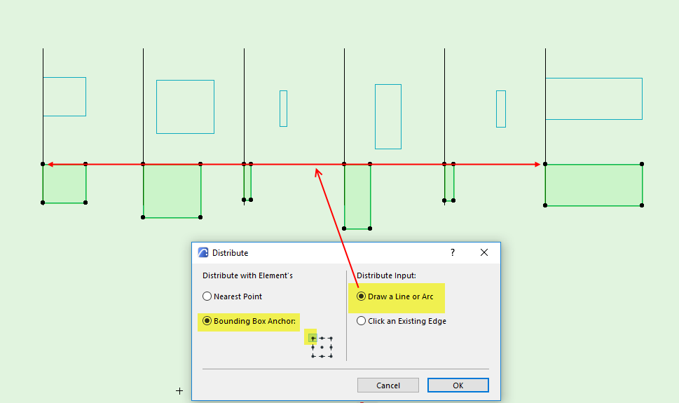

Are you aware of the 'Distribute' command?
If the first and last elements are in the correct position, you can select those and other elements in between.
Distribute will then spread them out evenly.
That is an interesting concept. Exactly how would that approach work with elements such as multi-segment walls, polygonal slabs and roofs though?
For elements like walls and columns that you just want to distribute to an even spacing, it will be fine.
Note, they are not snapping to the grids - just being distributed equally.
For irregular shape elements like slabs and roof, I don't think you would be distributing them.
More like aligning their edge to a grid?
But there is a 'special distribute' that allows you to pick a point on the bounding box of the elements, and then draw a line to represent the distribution length and position.
