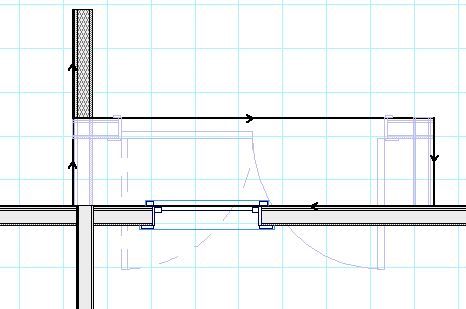

If I have my wall reference lines turned on and ghost story display on, the wall reference lines of the ghosted story appear in black, no matter what color I set the ghost story to. The rest of the wall lines, objects etc appear in the ghost story color.
In ArchiCAD 9, the wall reference line of the ghost story appeared in the color I set the ghost story to, but with a heavier weight line.
Is there any way to get back to this type of display in AC10? I find that when I see the black wall lines, I confuse the ghost story walls with the walls that are on the current story.
Thanks.

I can confirm this behaviour in Build 966.
It seems to be the Cut Line Pen is used even when ghosted.
