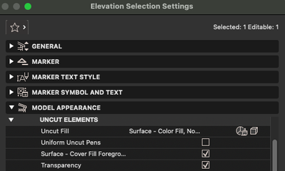

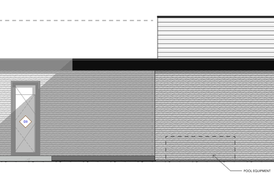

Wish: Transparent objects (such as MEP items) in elevation (to see the wall beyond),
So, I turned on Transparency in Elevation Settings.
Then, I want windows/doors (all glass) to be opaque in elevation so as to not see into the house. Lastly, the windows should still be transparent in 3D.
My graphic override was unsuccessful (I overrode Glass - Clear (surface) to Color - White, but to no luck.)

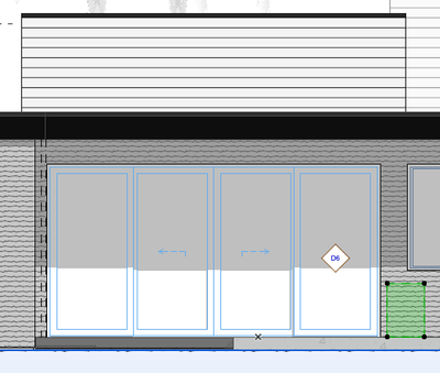

The issue is:
Overriding the Glass surface turns both the glass and window/door frame the same color, though I can't seem to get the frame black, and the glass white. It's minor, but important to delineate materials.
@architect wrote
The issue is:
Graphic Overrides will affect the entire element, not just the part (surface) you want to change.
If you don't mind the windows always being non-transparent, just use a non-transparent material for the glass in the object settings.
