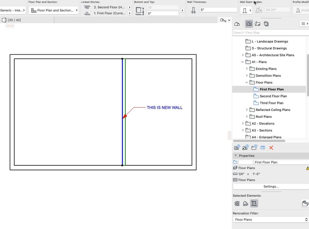

good morning, simple problem. I want to show new walls in plan with a hatch. the Renovation Filter > Floor Plans > Graphic Override Rules is showing a hatch for New Elements, but walls that are designated New are still showing up as white, without the hatch. thanks, margaret

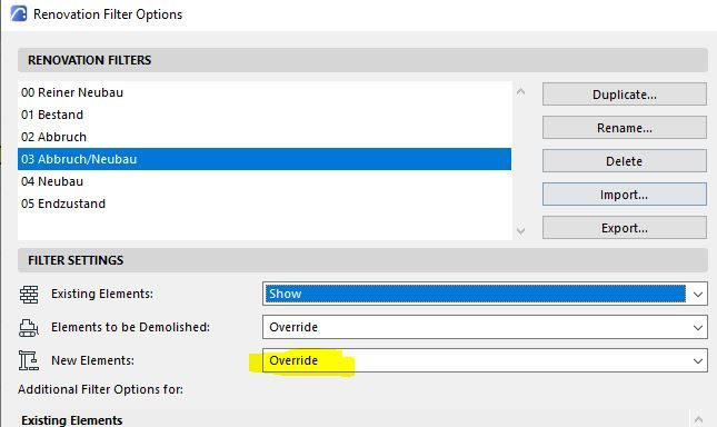

Solution
You should check Filter Settings in Renovation Filter Options, if you have selected "Override" for New Elements, as picture above.

Make sure your Renovation Filter is set to a filter type that is configured to override 'new' elements.

mserrato
no, and I'm sure wall in question is "new item" on renovation pallet.
Solution

that's it! thanks Andrii. I'm just coming to Archicad from Revit, and I'm baffled by the number of options.....
