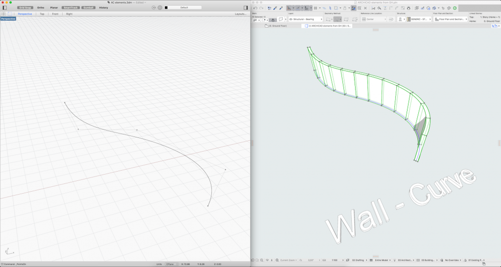

Wall
Necessary input: planar 2D curve (line, polyline, curve) in the horizontal plane. This curve defines the Wall's reference line
Tip: ARCHICAD segments the Rhino-Grasshopper NURBS curves and approximates them with arcs. Therefore one Grasshopper curve can result in multiple ARCHICAD walls.

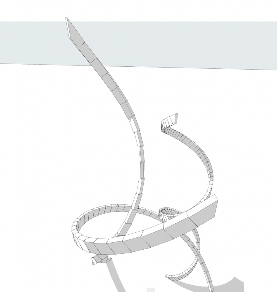

Beam
Necessary input: 3D curve in any direction
Tip: The more horizontal the reference curve is, the more accurate the resulting ARCHICAD beam will be. If the reference curve's inclination is too steep, the curve will be segmented into small parts and the beams will be distorted. [caption id="attachment_74425" align="aligncenter" width="912"]
Distorted beams if the inclination angle of the reference curve is steep[/caption]

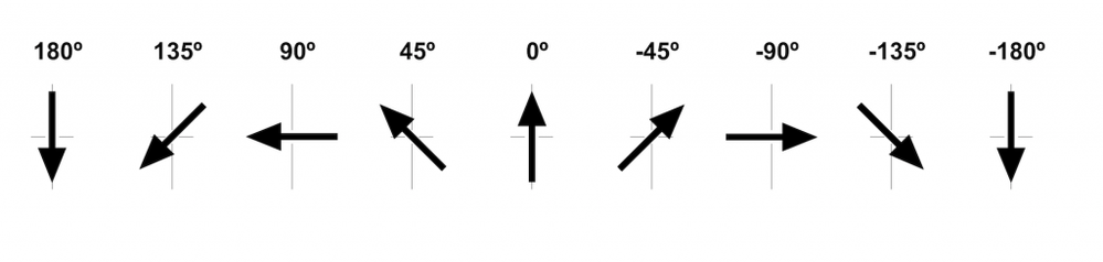

Distorted columns when the slant angle of the source curve is small[/caption] Tip2: Columns have a rotation angle from -180 to +180 degrees so the grasshopper code have to be set up in this coordinate system if rotated columns are necessary. [caption id="attachment_74439" align="aligncenter" width="912"]
Column rotation angles in ARCHICAD. 0° is the positive Y direction.[/caption] Example on how to place columns perpendicular to a curve:

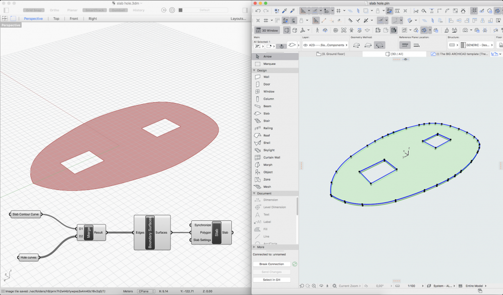

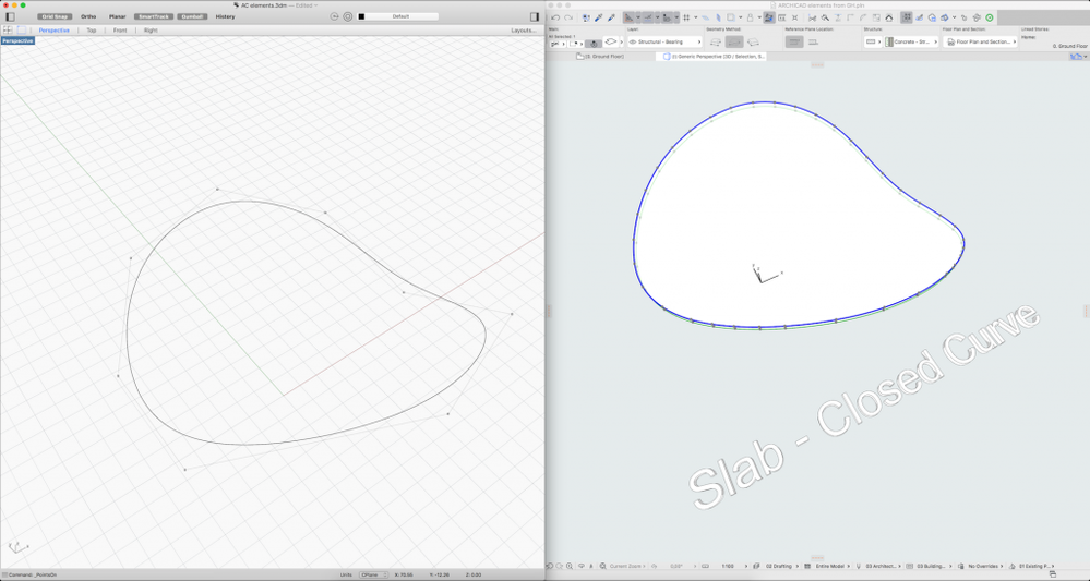

Slab
Necessary input: Closed 2D planar curve in horizontal plane. This closed curve gives the the Slab's edge.
Tip: It is possible to create Slabs with holes if you use a Grasshopper surface as an input for the Slab Polygon. The same technique works for Single Plane Roofs and 2D Fills.

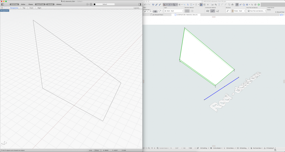

Roof (single plane)
Necessary input: Closed 2D planar curve in any plane.
Tip: The inclination of the planes must be between -89 and 89 degrees (this is the angle that is interpretable by the ARCHICAD roof tool)

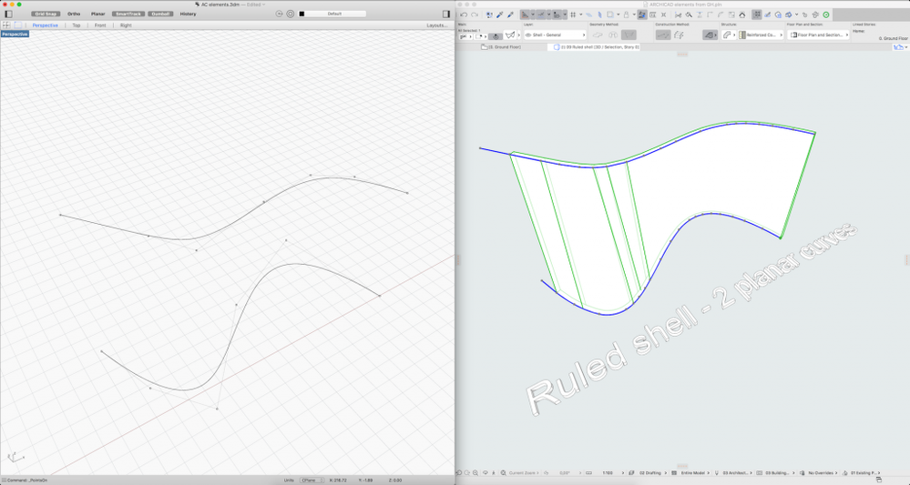

Ruled Shell
Necessary input: Two 2D planar curves (the planes of the two curves have to be parallel). The curves can be closed or open.
Tip/good to know: This is the most versatile tool of the Grasshopper - ARCHICAD Live connection. Most double curved surfaces can be covered with the Ruled Shell tool (or a series of them).

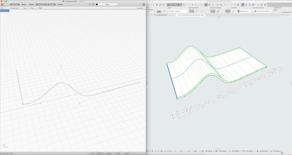

Extruded shell
Necessary input: 2D planar profile curve and an extrusion vector (the vector has to be perpendicular to the profile curve's plane)

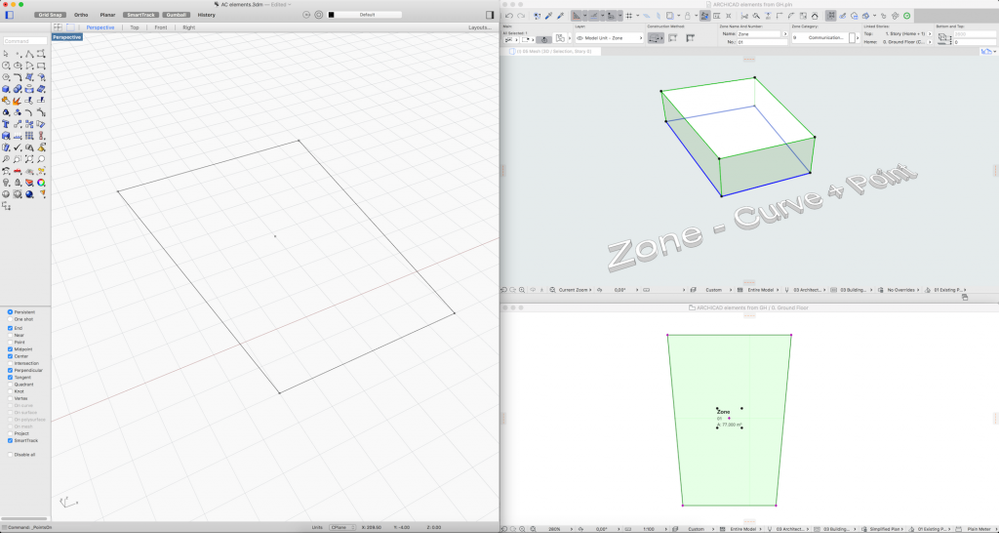

Zone
Necessary input: Closed 2D planar curve in horizontal plane and the zone stamp's anchor position (The zone stamp is only visible on the ARCHICAD Floor plan)

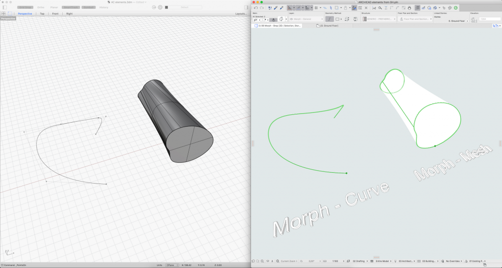

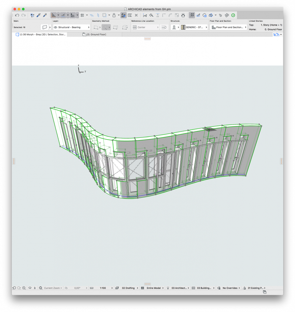

Morph
Necessary input: 3D curve or Mesh geometry.
Tip: The polygon number of the Solid Morph's mesh can be controlled with the different Mesh Settings node in Grasshopper. [caption id="attachment_74442" align="aligncenter" width="700"]
Mesh Settings (Custom node) with different options to fine-tune the quality of the resulting mesh.[/caption]
