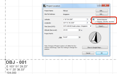

Enter Project Name, Full Site Address, Latitude, Longitude, Time Zone, Altitude, and Project North. This can be verified in google Maps if you have an internet connection by clicking on Show in Google Maps…

7., Click in the origin point to place and verify (The latitude and longitude representation shall be switched to Degrees, Minutes, and Seconds by clicking on the small arrow next to the text box).
Switching Latitude and Longitude to Degrees, Minutes, Seconds

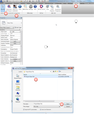

Open a new project in REVIT (make sure Archicad Connection Add-In is installed)
1., Go to the menu Add-Ins.
2., Then to the Archicad Connection panel.
3., Click on Improved IFC Import.
4., Choose the file.
5., Click Open. That import the IFC file and shows in Section.

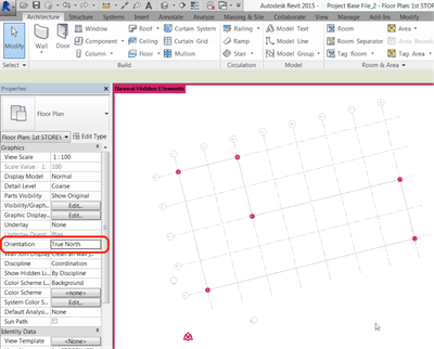

1., Click 1st story plan to open the floor plan.
2., In the floor plan, click on Revel Hidden Elements at the bottom of the view to show the Survey Point and Project Base Point. The points will match the origin point in Archicad.
Verification of the Settings – True North
Change Orientation (in view properties) to True North to verify the orientation set in Archicad.

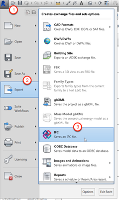

1., Go to the Application menu.
2., Choose Export.
3., Choose IFC.

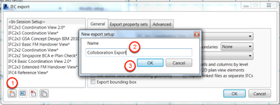

1., Click on the icon to create new one (If there is an existing one then just verify and choose the existing setup).
2., Name the settings.
3., Click OK.

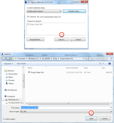

1., Click Export…. Specify a file name and click Save to complete the export.
