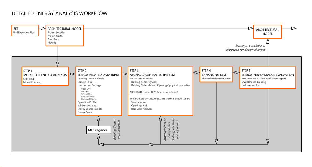

The workflow:
STEP 1: Modelling and model checking
We want to give you guidelines and best practices for modelling and model checking in this section.
1. Set up Project Preferences
Set up the following as per the BEP (BIM Execution Plan) of the project (these should be set up in the project template first). See Location Settings.

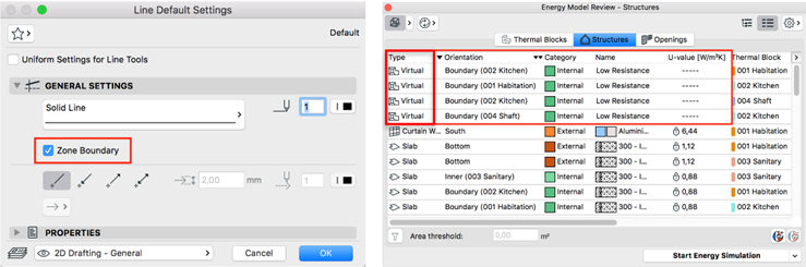

    • You can use 2D lines as zone boundary lines. Zones separated by such lines should be updated only on the floor plan. (Reason: 2D lines are not recognized as zone boundaries in 3D views, thus, as a result of the update, they will extend to reach the nearest 3D construction element.) These lines will work as space boundaries in the energy model.

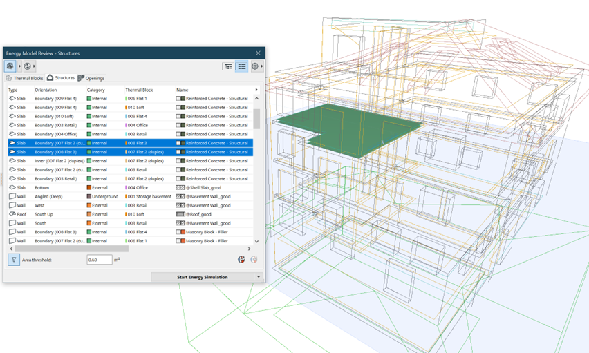

5. The Energy Model Review Palette
Start using the Energy Model Review Palette for model checking and the next steps of the workflow.
Design > Energy Evaluation > Energy Model Review
1 - Three tabs for the main components of the BEM (Building Energy Model): thermal blocks, structures and openings
2 - List of thermal blocks / structures / openings of the BEM (see Thermal Blocks in STEP 2)
3 - Properties of the selected thermal block / structure / opening
4 - Energy model visualization and update options
5 - Data input
6 - Energy simulation and export

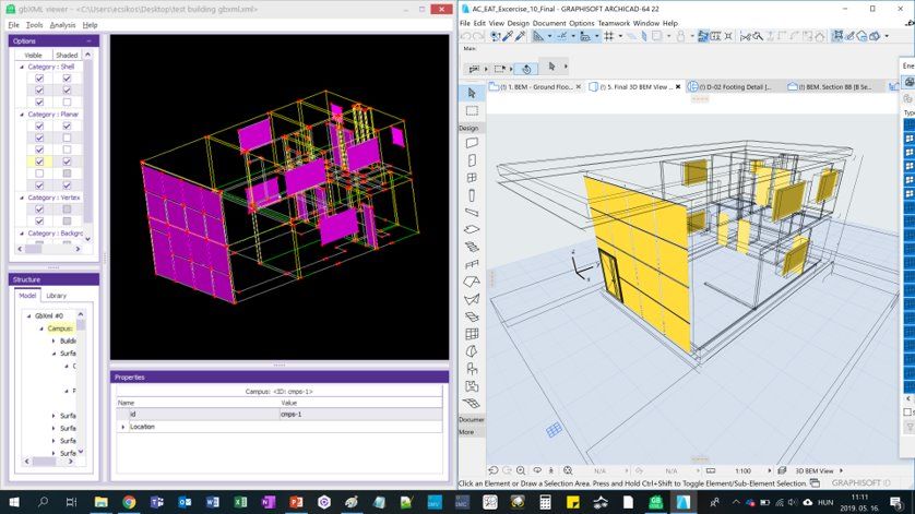

6. Model checking

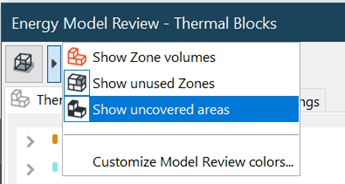

Check your model by visualizing it. See Building Energy Model Visualization
  1. Create at least one thermal block and assign all zones to it for model checking purposes. (Thermal Blocks will be defined more precisely in STEP 2 of the workflow.)
  2. Look for uncovered areas (marked purple): try to minimize their size, but don’t worry about narrow stripes appearing at, for example, the edges of slabs.

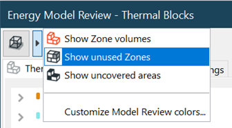

  3. Look for unused zones: make sure every zone is assigned to one of the Thermal Blocks.

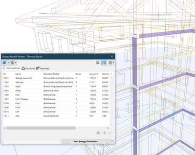

  1. Thermal Block Property Settings
    The definition of Thermal Blocks: a group of zones that share the same thermal characteristics. Zones that meet these three criteria, belong to or form the same Thermal Block within the building:
    - they are exposed to the same external impacts (their orientation is the same)
    - they are used the same way (they share the same Operation Profile, see below)
    - they are served by the the same Building Systems (see Building Systems below)
    There is some freedom in defining the Thermal Blocks. In a small building you can add all zones to the same Thermal Block for a quick estimation. see: Create Thermal Blocks

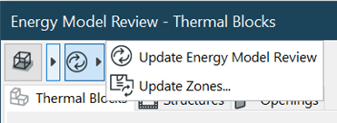

Note: update the zones of the model after any changes applied to them. Also update the energy model after changes in the model or in the data added (discussed in the section above, in STEP 2).

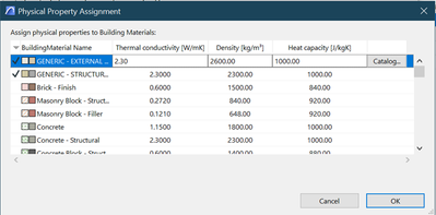

The Thermal Bridge Simulation is based on the details of the project, the fills assigned to the Building Materials and their physical properties.
You can add the effect of the thermal bridges in the energy model (even without EcoDesigner Star) on the Structures and the Openings pages of the Energy Model Review Palette.

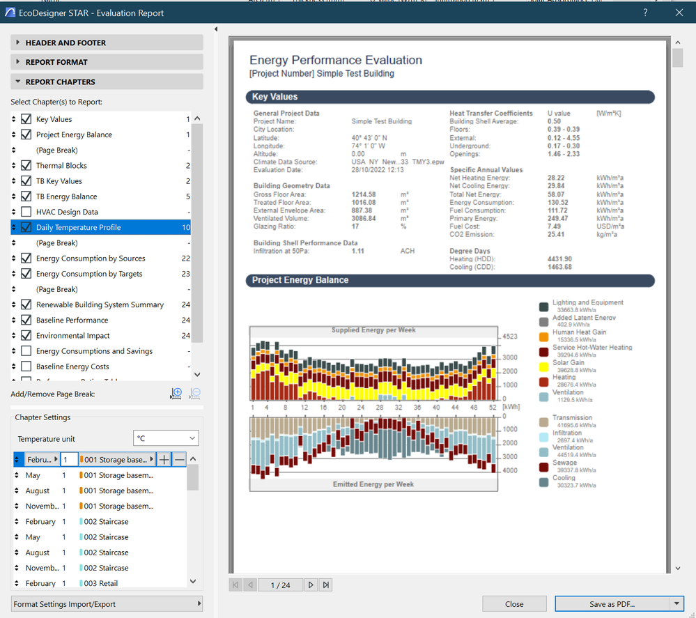

  1. Run the simulation and save the report.
    Start Energy Simulation
  1. You can save the first/current setup as a baseline building. It will serve as a base of comparison for future simulations of the enhanced model. (This is an EcoDesigner STAR feature. See the User Manual for details.) In the next simulations you can include a part in the report that will automatically compare the results to the baseline building’s results.
  2. Read the report and evaluate the energy performance of the building.
    Reading the Energy Performance Evaluation - PDF Report
    Reading the Energy Performance Evaluation - XLS Report

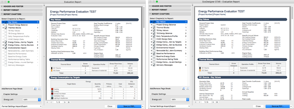

  3. Please note that some chapters of the report are only available with EcoDesigner Star (on the image below: Energy Evaluation report on the left, EcoDesigner Star report on the right).
    See the EcoDesigner User Manual (chapter 7) for more details.

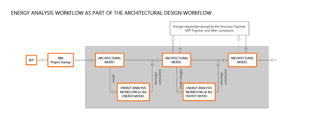

At this point one round of the analysis has been run. If there is a need for improvement in the energy efficiency, the conclusions, learnings, and suggestions for design changes can/should be implemented in the architectural model. The simulation should be repeated after each major design change and the results should be compared to the baseline building’s results. If there are multiple design options, a separate energy model should be developed for each of them, and the simulation should be run for each of them to see which option is best from the energy efficiency point of view. This way, the energy analysis becomes an integral part of the architectural design workflow and contributes to the quality of the final design. See the workflow diagram below. (Other impacts, such as the suggested changes as the results of the coordination with the structural or the MEP engineer are also signalled on the diagram.)
During later phases of the design development, more accurate calculations are usually needed to make sure that the building will comply with the local energy efficiency requirements. For this purpose, an energy analysis consultant should be involved who performs the analysis using an energy analysis software based on the data we extract from Archicad (in .gbxml format). This also requires the energy model to be updated with the changes to export the model and the data most accurately. If the client aims to build a building that will get one of the current green building ratings, (such as LEED, BREEAM or Passive House), the energy expert needs to be involved from the very early stages of the project.
