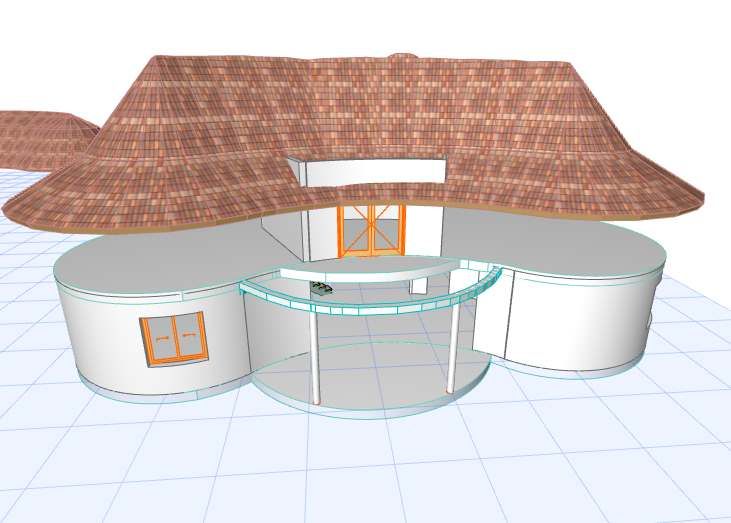

I am a newbie and need help with a roof. My project involves ground and first storeys. I need the roof to start above the first story, angle on the ceiling of the first story and finish on the floor of the first story. How can i stretch the roof as you can see in the image is not reaching the floor.
Secondly, this roof is meant to be a thatched roof. How do you do that?
Select the roof and adjust the height in the Info box until it is at the right level. If the roof is assigned to a story (rather than story being selected "automatically") it will still display on the plan as it does now.

I have approximated this in the past with a thick roof with perpendicular edges, and created a material with a thatch-like texture and a suitable vectorial hatch for elevations. I can't post a picture unfortunately, as this was done at a previous workplace.

Heres my render with the roof done. I figured i can add the thatch later in my final rendering software

Yes sorry i tried uploading but i couldnt heres 1 of the pictures
