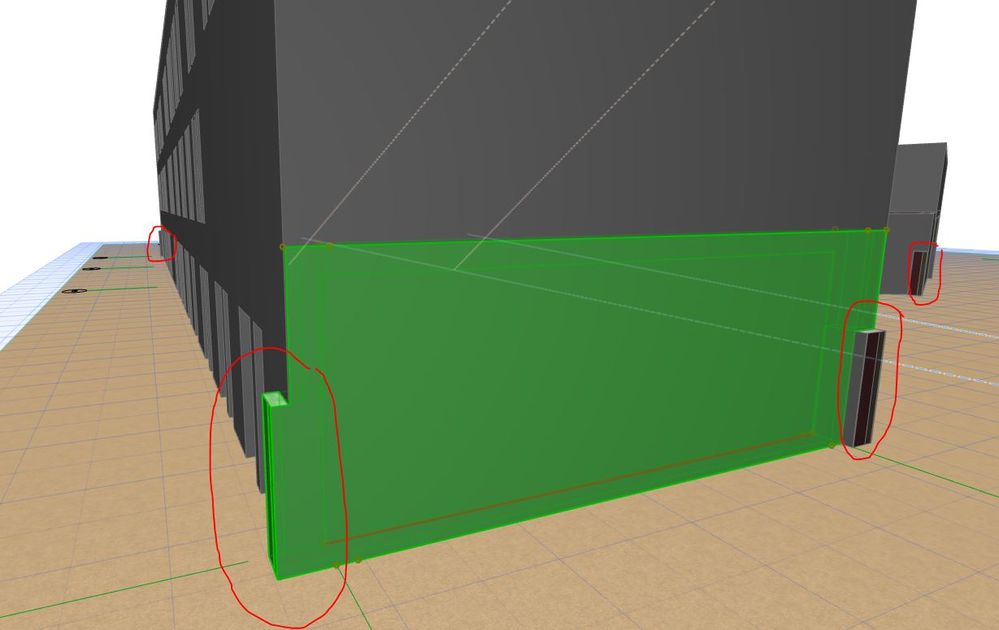

I am a fresher to this forum and I have a certain issue with my model. I've been cleaning my sections and when I turned on 3d view whole ground floor walls, started to partially stick out on intersections with another wall. I attached screen shot of my model below. By any chance do you know how to solve my issue? It happens only on the ground floor.
Thanks for your help in advance.

Solved - It was the foundation wall finishing above Level 0 of the project. Should I delete my post now? If case anyone find It helpful, I leave it here 😉
