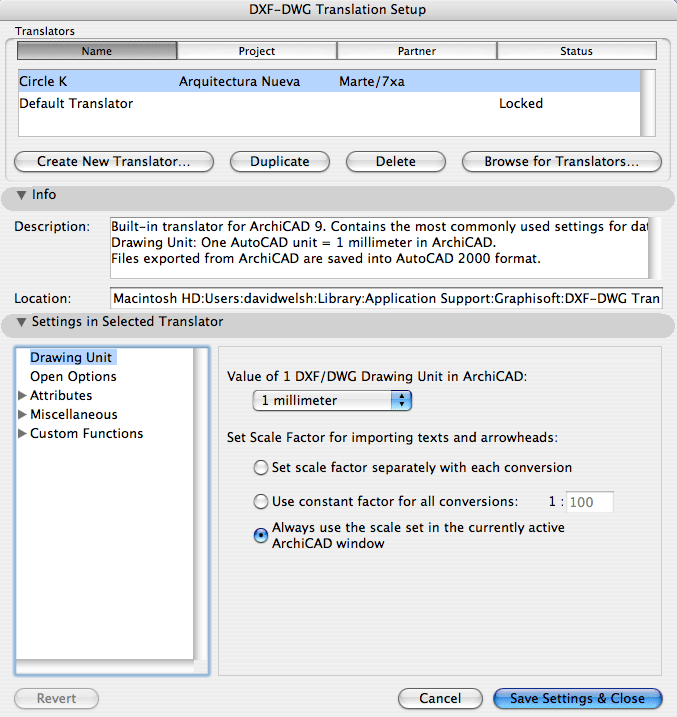

I have problems importing a dwg, file. I f I“m wrong please just tell me, maybe I“m missing a step.This is the procedure first I go to file, open file, enable dwg file, select, and then click on settings.
13 REPLIES 13
Then on settings, I duplicate the DEFAULT TRANSLATOR, and rename it. Then on drawing unit check, the value that I want mm, here I have selected the last one, but I“m not sure if this is the correctly.
Open options,

So far so gopod mate. Next step is to select a translator. If you haven't already, start by duplicating the Default Translator and editing it if needed.
Then just continue inserting the DWG, skip all SHX files ( the text will just import using your default font) and missing images (if any), and bob's a gameshow host.

then attributes, layers, line types, custom functions (open extras), save settings.
then I choose a file, to extract elements to that folder
the scale of the dwg file is lost, why this happens?, is the file bad, or my procedure?

Sorry - my previous post caught you after step one!
So the scale is completely separate - set that *before* you open/merge/attach the DWG. It is something you set first!

Link, thanks for your post, I“m trying to merge the file, but it still doing me the same, as the example I had made., the scale is lost. Can you be more explicit.?
