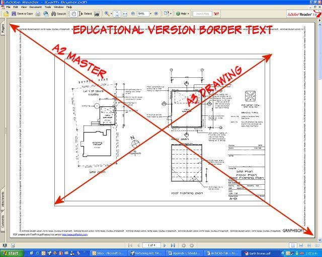

I don't know if this would work, 'cos I've never tried it,
Your "friend" could maybe format their drawings on a larger Master than needed, then print to the size required from PDF file, centred, with no scaling. The border text might be omitted because it is outside the sheet you are printing too.
eg. for A3 drawings, set out Master with A3 title and border in the middle of an A2 size master. (Not sure what the US equivalent sizes are, but you'll probably work it out.)
Hope this helps.
