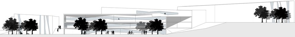

Hello everyone, i need some help, can anyone tell me how can i do windows like the ones in the elevation i attached?
And how can i do openings like that ones in the walls?
Is that possible?
I made those with lines on elevation and made the rest on phothoshop, but since its not done in archicad i cant do renders cause i dont have the windows like that.
I thank you in advance for all the help, i hope someone can lead me in the right path on how to do that.

Pretty easy.
For actual windows, which behave as windows, schedule, etc., see this article (and many threads here for 'custom windows'):
http://www.archicadwiki.com/CustomShapeDoorWindow?highlight=%28custom%29%7C%28window%29
and this summary tip linked from there:
http://www.facebook.com/photo.php?fbid=426037663042&set=a.426037433042.204952.191457003042&theater
For schematic design when things are fluid and you want your shapes to be easily changed just to show an idea, try Dwight's idea here:
http://www.archicadwiki.com/CreateCustomWindows?highlight=%28custom%29%7C%28window%29
Have fun. Post your results. 😉
Cheers,
Karl
AC 29 USA and earlier   •   hardware key   •   macOS Taho 26.1 MacBook Pro M2 Max 12CPU/30GPU cores, 32GB
Hi Karl, i tested one of the solutions you proposed and it seams to work! When i have more free time i will test the rest.
Thank you for your help, i will post the results when i finish the work.
