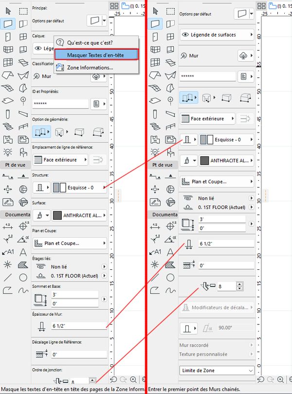

Hidden gems: gain more space in Info Box Palette
Ahmed_K
Mentor
Right click in the toolbox settings bar, click on hide headers , and VOILA !

Good tip. Here is the Info Box in English.

Damn, 10+ years using ArchiCAD and I never knew about this one before. 😆
