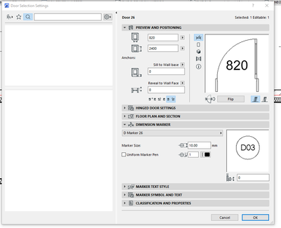

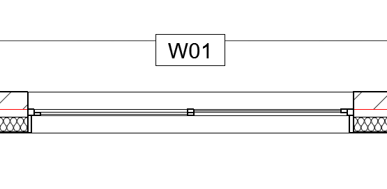

Hi Everyone,
I am trying to figure out how and where to save the custom markers that I have made for my doors and window so that I can import them into my future projects and template. I see the option "load other window-door marker..." and would be great if anyone can help and explain how to save this custom markers and reload them into future projects as it will save me a lot of time.

To succeed in registering a door mark, you must first make a copy of an existing mark, adjust the parameters as desired and then be able to export.
I made a video in French that shows how to do it
She should be able to help you
https://www.youtube.com/watch?v=rRfNmwvMmNs

Put the marker in a folder, then add that folder to your loaded libraries via the Library Manager, then Reload & Apply (button at bottom left corner). Also add that folder to your ArchiCAD template file so the marker is available in future projects. Some users have a company library folder so they have the same custom parts available in all their projects.

Thank you for your response. How do I save the Marker in the first place, I can't seem to figure it out as I am still new to ArchiCAD.

shir_khann
Hello Yves,
 I am using the standard D Marker 26 for Doors and W Marker 26 for Windows as seen in the photo below. I am just trying to find out how to save this marker in a template or local file on my computer to reuse it in future projects.

shir_khann:
I am not sure what you are trying to do. The D Marker 26 is part of the Archicad Library 26, so it will be an option if that library is loaded. If you save a Favorite of a door with the marker settings, the marker settings will be saved as part of that favorite.

shir_khann
Hi Yves,
This is exactly what I was looking for and easy to follow. Thank you
