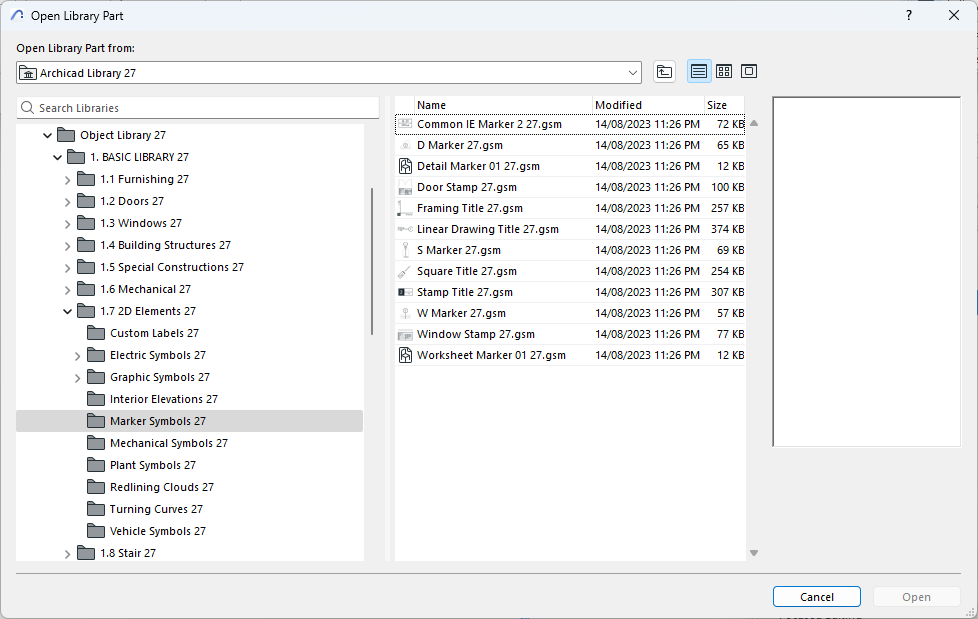

I don't speak French, but all they are doing is opening the library part in the object editor.
File menu > Libraries and Objects > Open Object.
Browse for the Marker Symbols folder and open the marker that you want.
In my AUS library ...
Then edit the settings and then 'Save As' with a new name.
If you save this in the Embedded Library, it will only be available in that file.
You will then have to save it to an external solder.
Or just save it directly to an external folder (ideally your office library) so that you can load it in any file.

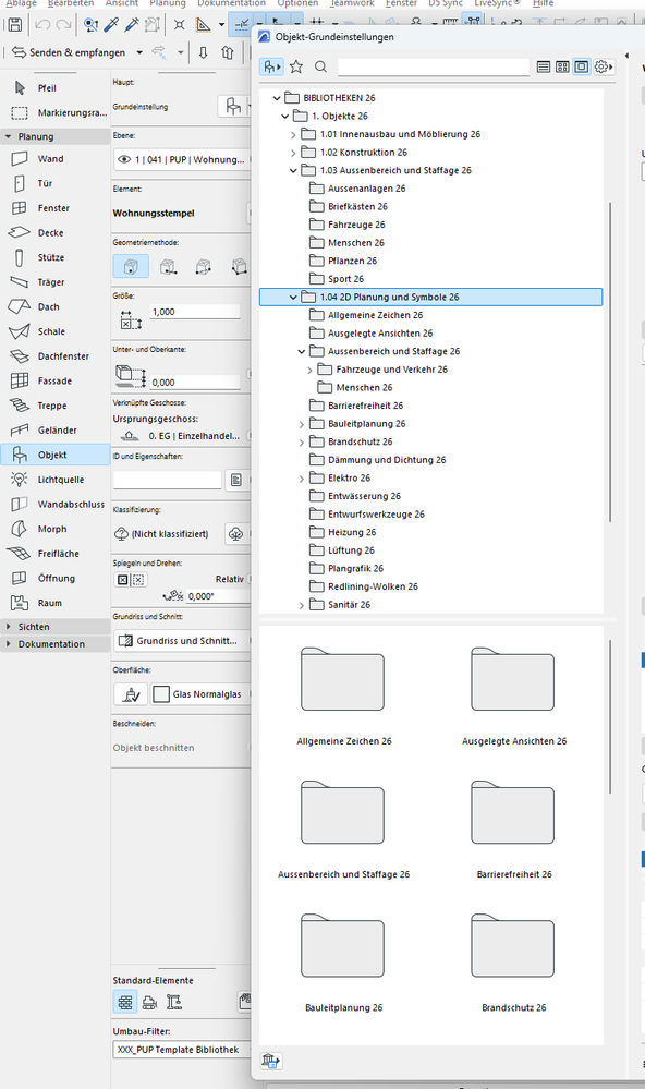

I also thought that door marker is located somewhere in the object library, but I couldn´t find it anywhere.
Just to verify, the object should be somewhere here, right?
When I say they are objects, they are special objects with their own object sub-type.
So they are not useable with the object tool.

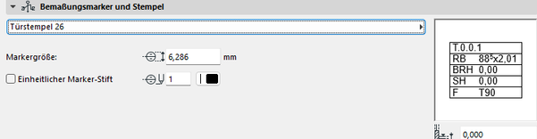

They can only be seen in the list of markers in the door and window settings.
If you have created a 'custom' marker, then you should find it in your Embedded Library.
The marker list in the door and widow settings will automatically find all markers in all of your loaded libraries.

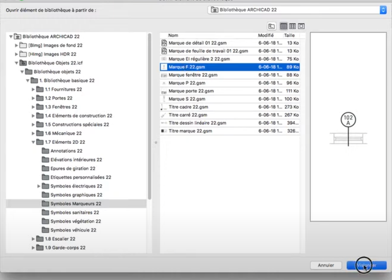

I see here that a current door marker type first has to be found and copied in order to be customized:
But when I open this library, there are no door markers inside.
