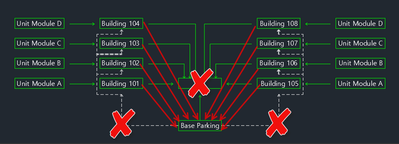

How do I work with hotlinks?
I need to connect a hotlink like this.
I know it's wrong.
How do I connect a hotlink to solve this?
AC27 on window 11

LeeJaeYoung
Is it too complicated to explain?
What is this?
AC27 on window 11
LeeJaeYoung
This is a question of how you are doing because there is no overlap in autocad and Revit.

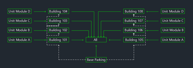

LeeJaeYoung
The description of hotlinks in this book is of no use to me.
I made 7 buildings.(building 1~7.pln)
But you have to collect these buildings. With underground parking..(all building.pln)
However, since it is a mountain, the starting position and height of each building are different.
So you cannot create a building section in all building.pln.
(It would be possible if the story was drawn by hand... or if the story could be dragged for each section...)
So I have to collect one building and an underground parking lot.
For the cross-sections that are expressed up to the underground parking lot ....
unit.mod -> building 1.pln -> full building 1.pln <- basement parking.pln
full building 1.pln has gdl issues.
The question is here.
zone stamp in hotlink - Graphisoft Community
It is connected to the content about overlap that I asked about last time.
AC27 on window 11

LeeJaeYoung
Did you read what I wrote?
AC27 on window 11
I am not a hotlink expert - I rarely use them.
So if anyone want to correct me - please feel free.
'Unit Module' into' Building' is no problem.
'Building' into 'All' is no problem and that will bring in the 'Unit Modules' as well.
'Base Parking' into 'All' is no problem.
'Base Parking' into' Building' is no problem, but you are then linking 8 x 'Building' into 'All' that already has the 'Base Parking' in it.
So to me you are getting 9 copies of 'Base Parking' in the 'All' file.
I would skip 'All' completely and just link the 'Buildings' into 'Base Parking'.
Don't link the "Base Parking' into the 'Building' modules either.
Each 'Building' hotlink can have its own master layer.
That way you can turn each 'Building' on individually on the 'Base Parking' (by turning the other 'Building' master layers off), or you can show all of the 'Building' modules by turning all of the 'Building' master layers on.
That is how I would do it.
