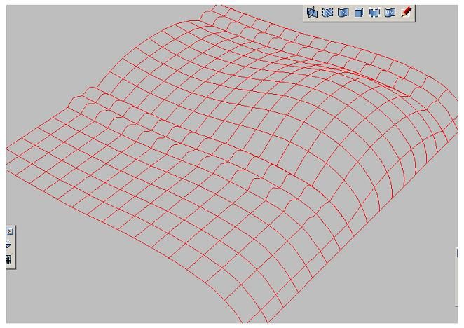

Does anyone have a tip how to make this in archicad? I have tried mesh, roof, walls but nothing works.
I have tried to export it from Rhino as a 3ds, but it looks like bad.
Can i model it in archicad?
Thanks

I believe that there is a parametric object 'out there', possibly created by David Nicholson-Cole (DNC), that will do something very similar. As I recall, I think it is called 'Supershape'

re 3ds: are you applying import option "Force Smooth" - that tool named after the super hero team who are good with women?
it's called 'stretchymembrane' - i have it, but i'm not sure if it's a freebie to distribute or not. DNC?
Try ArchiForma.
